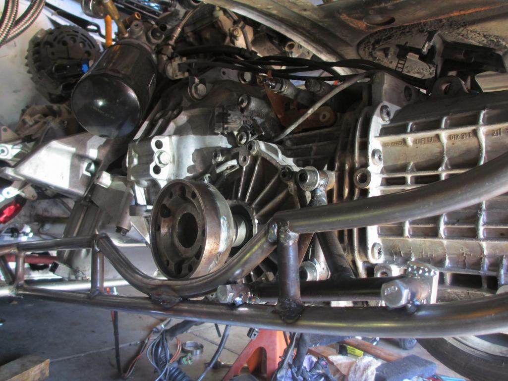

Here is the challenge. The transaxle. Either I fab an adapter, Fab an axle to take 1 Porsche CV and 1 Audi/VW CV or Replace with Boxster tranny, that will: Bolt right on, Shifter is cheap and available and requires less fab time. I'm leaning to the Boxster due to the 100mm Porsche CV flange. The Audi is 114mm.

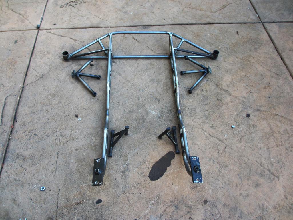

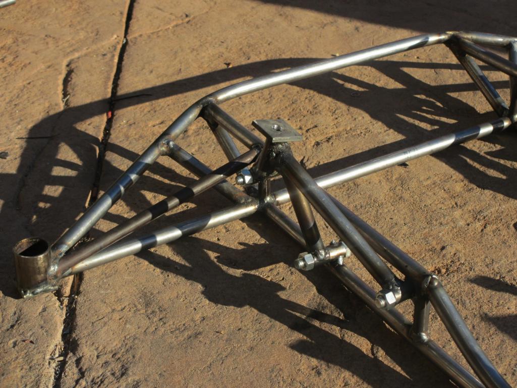

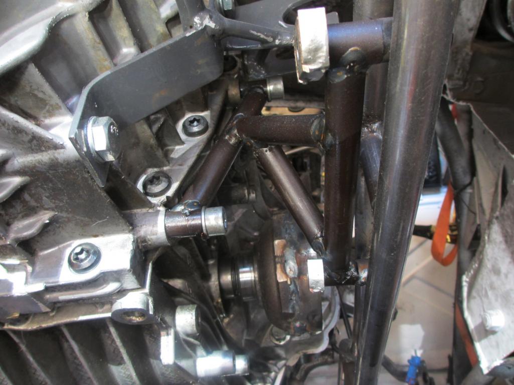

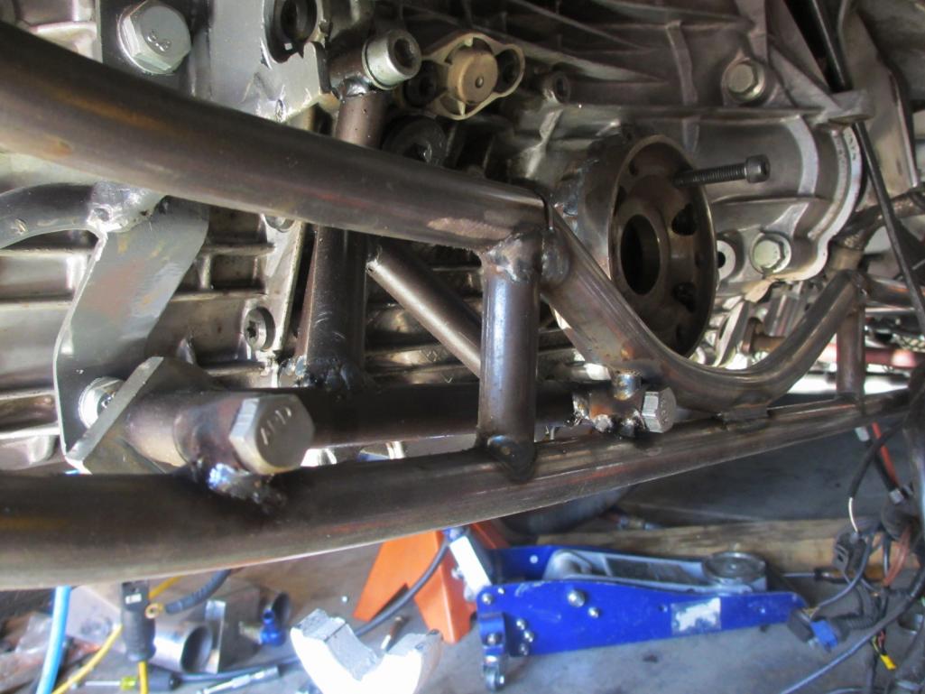

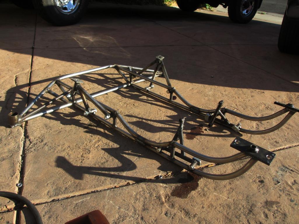

Today was spent, all day, fabricating mounts. I did something smart, I made mounting tabd on the cradle to pick up the tranny and motor mounts. That way If I swap engines, again, I can re-use the cradle and only fab new mounts. I also burned up almost all my DOM. Surprised I didn't run out of welding wire or gas... I'm sure glad I can fab myself, although it would be nicer if I had a shop and slowed down a little. I could not afford to pay someone to do this. This is one of those days where you would have to explain to the customer that it actually did take 10 hours to create mounts. Then try to get them to pay...
I used the axle stubs to measure for level. There are no level parts on the engine. Everything line up great...
