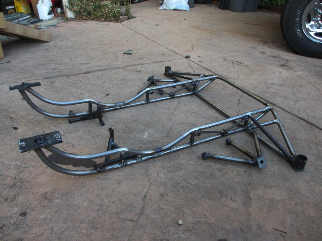

here is the final system welded. Need some more grinding and finishing but it looks pretty good. For those that are counting, the cradle weighs exactly 24.6 lbs. The engine and tranny mounts a few pounds more...
That's it for now. We'll see what I get done this week after work... BTW, the new oil stains on the driveway anr from the nounts. I gave them a dirty oil bath after welding. Apparently I missed a weld and the filled up with oil, then they drained out... (IMG:style_emoticons/default/sad.gif)

kg6dxn   Today was spent, all day, fabricating mounts. I di...   Oct 7 2012, 08:45 PM
kg6dxn   here is the final system welded. Need some more gr...   Oct 7 2012, 08:48 PM
Dr Evil   Work of art, Mike :thumbsup:   Oct 7 2012, 08:59 PM
kg6dxn   Work of art, Mike :thumbsup: Thanks Doc! Tha...   Oct 7 2012, 09:03 PM
