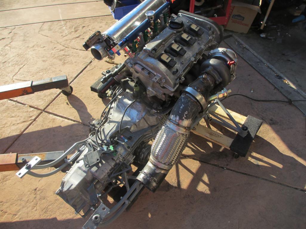

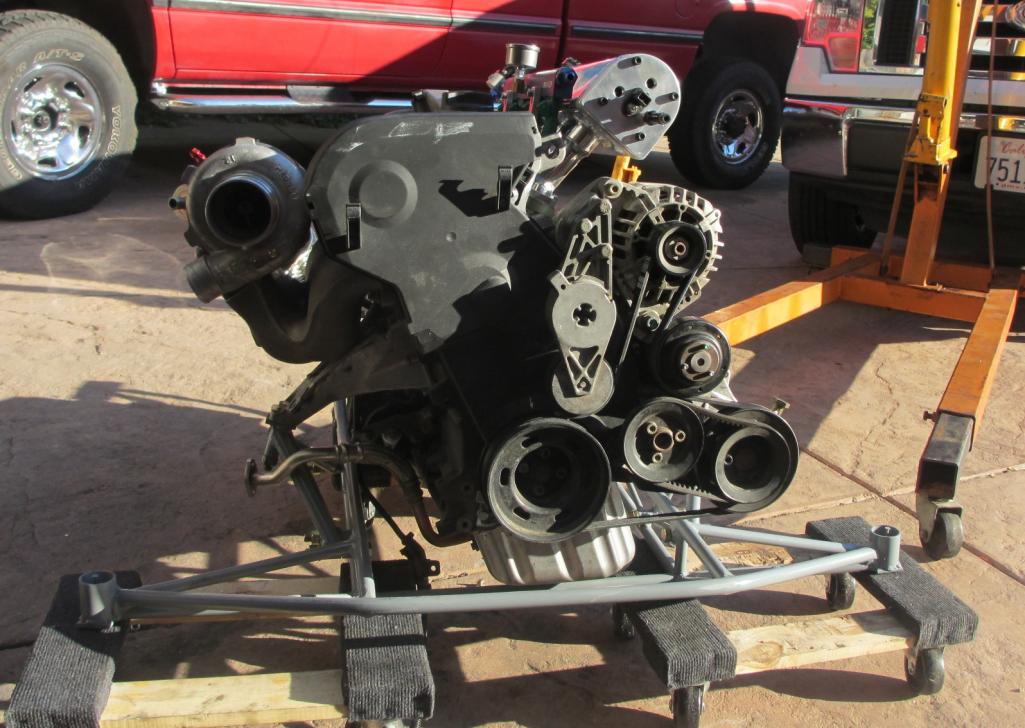

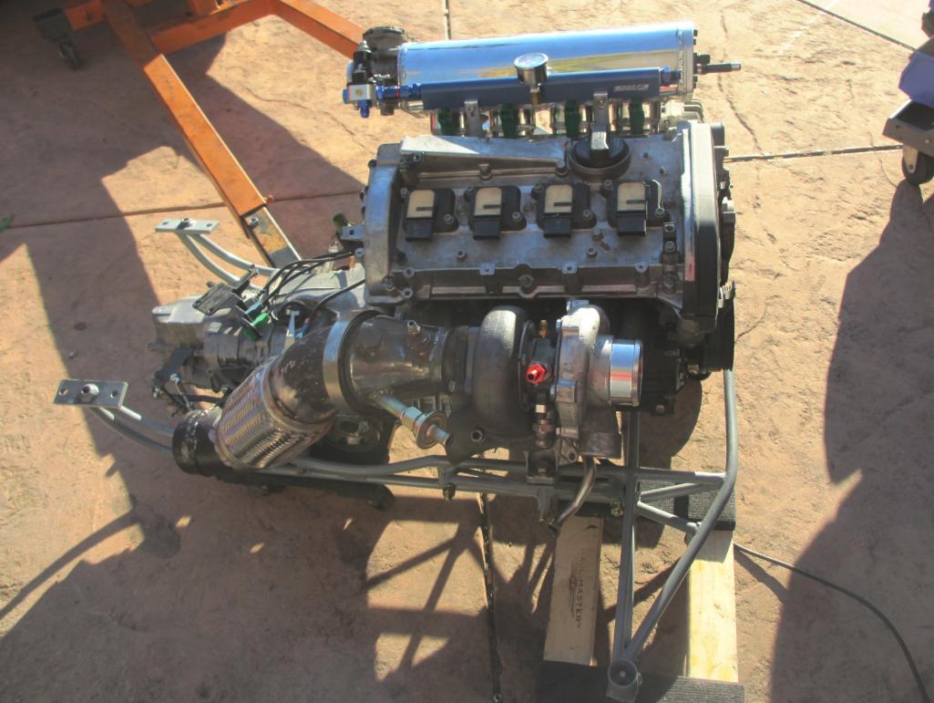

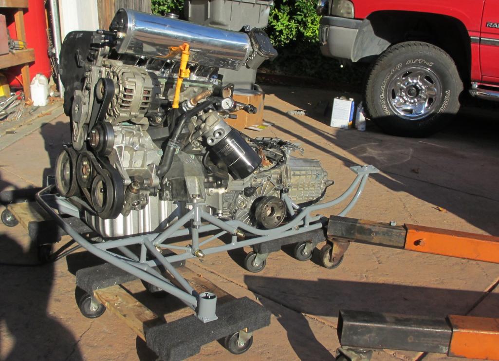

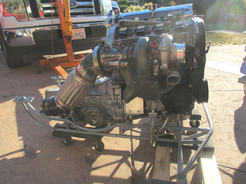

Here she is in all her glory. Engine mounted to the cradle. Intake and exhaust mocked up. The cradle sure makes it east to maneuver around. The nuts on the under side of the exhaust manifold will be a challenge. So far I cannot get a wrench on the center one... (IMG:style_emoticons/default/sad.gif)
Enough work for today. I'm tired...

kg6dxn   Here she is in all her glory. Engine mounted to th...   Oct 13 2012, 07:01 PM
kg6dxn   The cool thing about the OBX (don't laugh) int...   Oct 13 2012, 07:10 PM
rohar   That's really comming together. I love that y...   Oct 13 2012, 08:13 PM
okieflyr   Mike, have you checked your height and clearance w...   Oct 13 2012, 09:14 PM
kg6dxn   Mike, have you checked your height and clearance ...   Oct 13 2012, 09:34 PM
