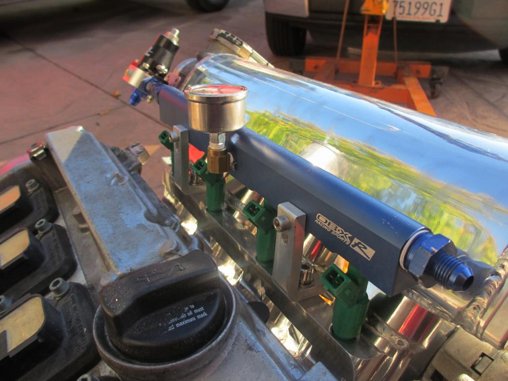

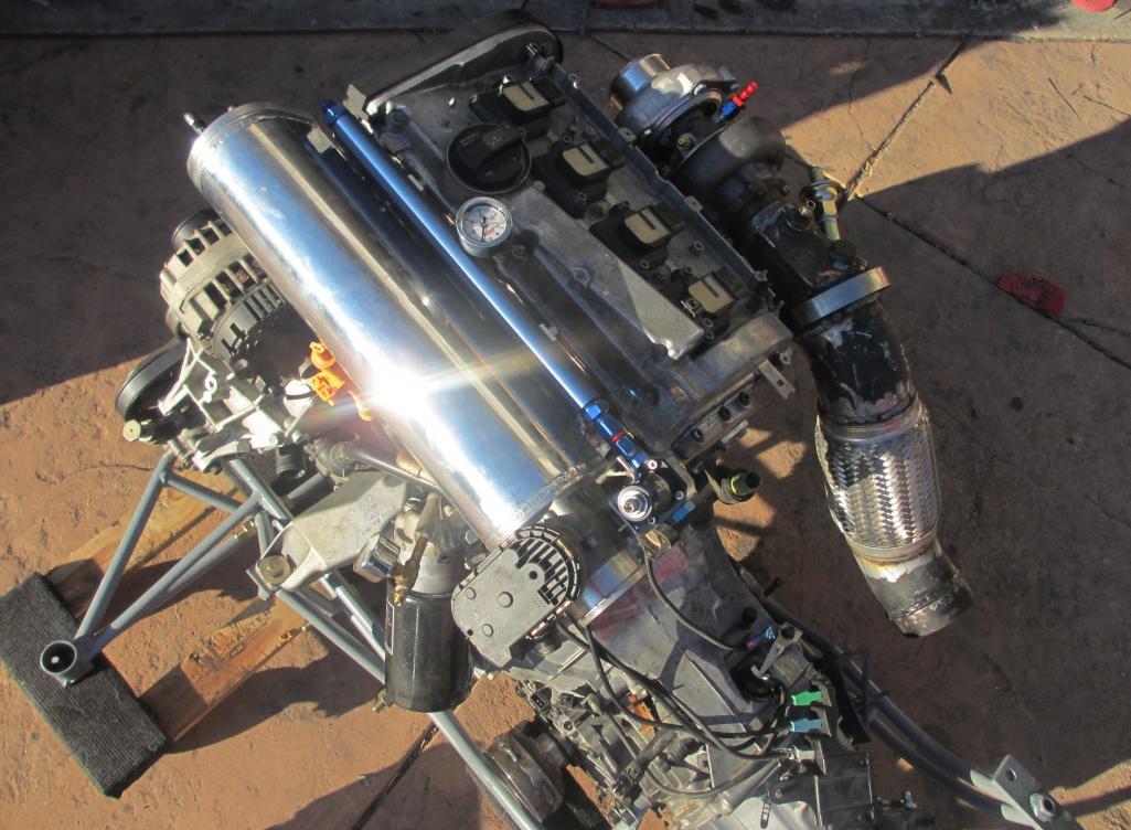

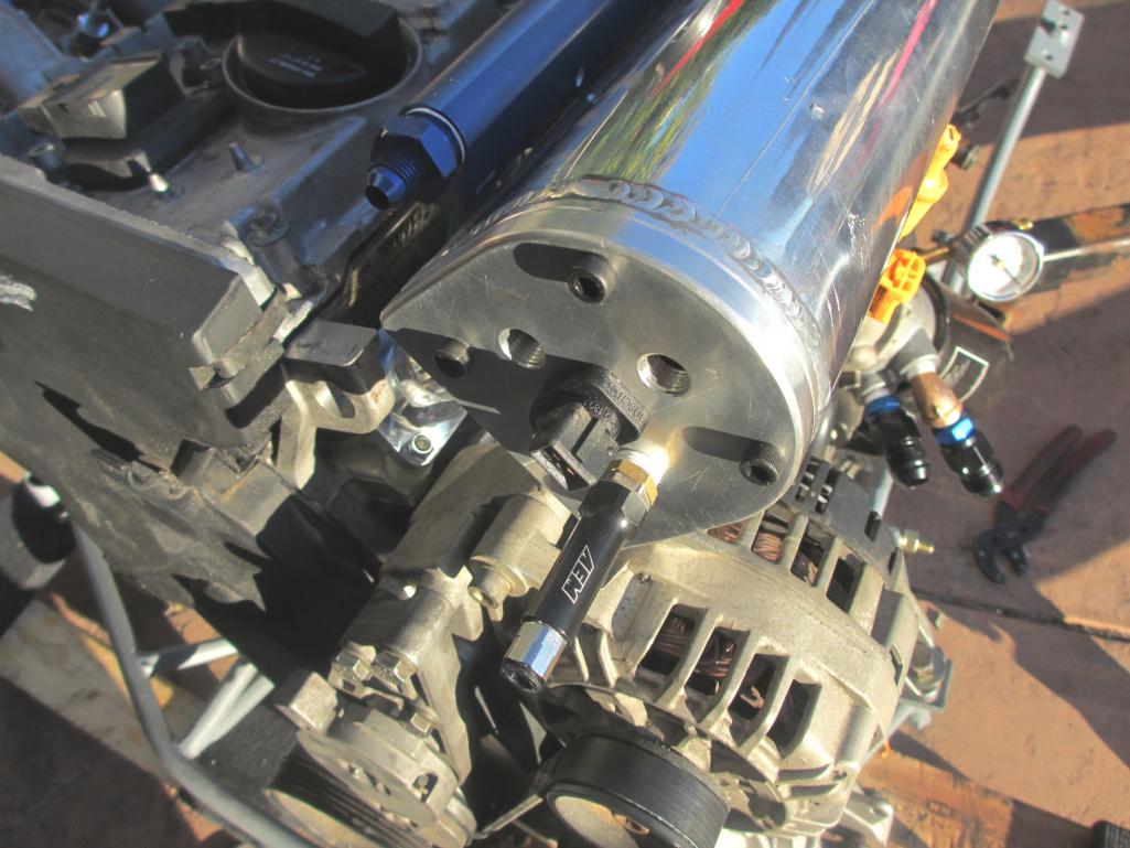

The cool thing about the OBX (don't laugh) intake manifold is the ability to swap the throttle body to the front or rear. Right now it's setup on the rear. My AEM methanol injector is on the front. The shitty thing about the OBX manifold was the fuel rail. The one that came with the manifold is polished and the -6AN fittings arn't right. They do not fit a -6AN fitting. Shitty Chinese manufacturing. I just happened to have another OBX rail and it worked with a little modification. Aeromotive 75psi regulator is hanging on the end. Not sure I will leave it there but we'll see...

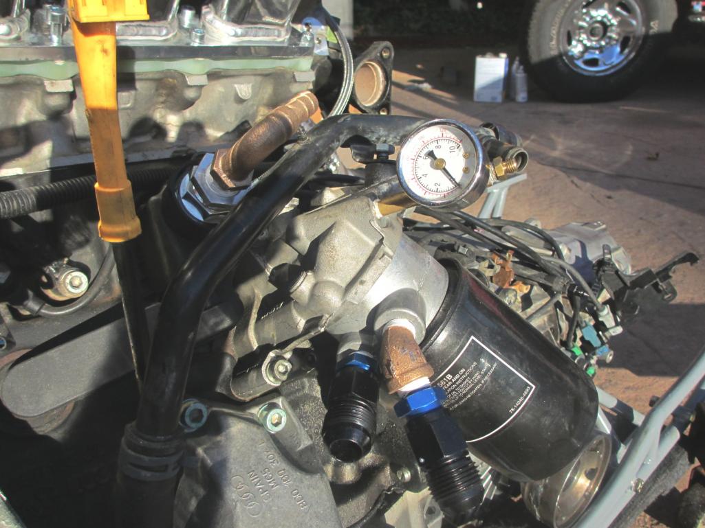

Here is the oil cooler attachment and Crankcase evacuation fitting visible. I removed the factory water cooled oil cooler and will run my -12AN oil cooler lines to it. (IMG:style_emoticons/default/smile.gif) I had to add a 45 elbow and -10 to -12 adapters. The elbow it for clearance between the -12 fittings only.
