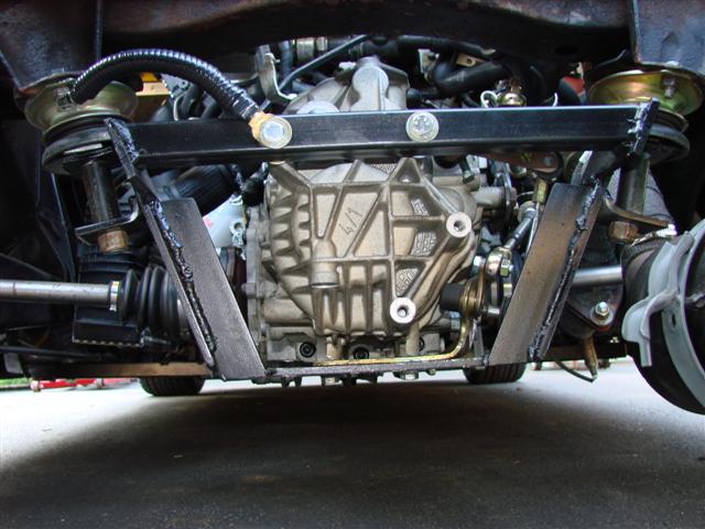

Mike, have you checked your height and clearance with the OBX manifold yet ?
Are you going to use any rubber or material between the cradle and body?
The cradle will hold and transfer alot of vibration to the body. I used stock 911 mounts at my four points of engine/ body mounting and it is very effective with the vibration. My engine lid will get excited for about 2 minutes when cold, but everthing is quiet beyond that.

I may have some engine lid clearance problems with the intake. Have to get it in and see. I can lower it down if I need to. Just have to fab new mounts. Lucky for me this is doable without messing with the cradle. (IMG:style_emoticons/default/smile.gif)
I have broken too many rubber mounts over the years. Including 911 mounts. These are solid just like my V8 was. I'm used to the added noise and vibration. I even have a set of aviation headsets for long drives when the V8 would drone on and on...
