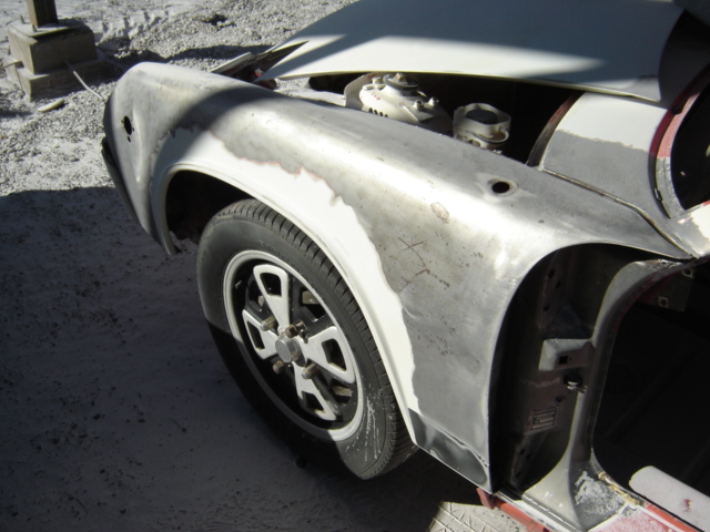

Hello. New here,so here goos.
Back in 2007 started to put the parts and chassie together. I have 3 chassis to work from,2 from Texas and one from Ca. The Texas car seems to be better/less rust but it was hit in the driver front and repaired. Will look into that when I get is up on Rotisserie. Will start building the Rotisserie next.
She will be powered by a JDM Sti using a adapter to the 914 transaxle. Didn't want to go to the Subaru,to much work.
When I get it up on the Rotisserie is this a good time to have blasted clean/paint free?
Here are some photos . Any input is welcome!
Randy

Here is a link to the chassis cleaning/Soda blasting.
(IMG:http://www.914world.com/bbs2/uploads_offsite/i916.photobucket.com-8123-1353797217.1.jpg)
http://www.914world.com/bbs2/index.php?showtopic=198596
