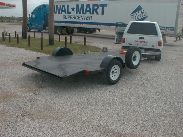

I spent quite some time browsing different posts of trailers used to transport 914s and finally decided to build my own. There only seemed to be a few single axle trailers with brakes shown on this board. I chose a single axle to keep the size down and make it easy to move by myself when it is not attached to the tow vehicle. I hope this thread serves as a means for others going through the same process a chance to see what others are doing without spending hours looking through posts with the word trailer. David Lee

Trailer deck is 6'6" wide and 10' long with an additional 2' of dovetail with a 4" drop. Frame is 2.5" square tube with .25" wall thinkness. The cross bars are 2.5" angle that is 3/8" thick. The axle is 3500 lbs rated with electric brakes. Ramps are 6" long and lock in under one side. The deck is plated with 14 gauge diamond plate and I added additional angle runners under the route that the tires take when loading the car. Total weight is about 1300 lbs. The heaviest car that I carry is my 914 V8. You must keep the total weight of a trailer in Texas under 4000 lbs to avoid titling it. I do have a VIN number now and registration, but no title needed. Saves a little cheese at least. The tires are 205-70-15 6 ply trailer tires with a lockable spare. Tongue is a 5000 lb Bulldog unit and a 2000 lb tongue jack. You will also notice a spot to store a floor jack (locked in place). Cost? The steel was free (thanks Gary) so my total outlay was only $650 including registration. It took two days to complete with my father-in-law helping on the chop saw. He didn't want to go shopping with the ladies, so he was captive labor.

dlee1967   How does it pull? Great....Local 914 support grou...   Jun 29 2004, 08:12 PM

dlee1967   No pics with a car on it yet. I towed a barn find...   Jun 29 2004, 08:59 PM
