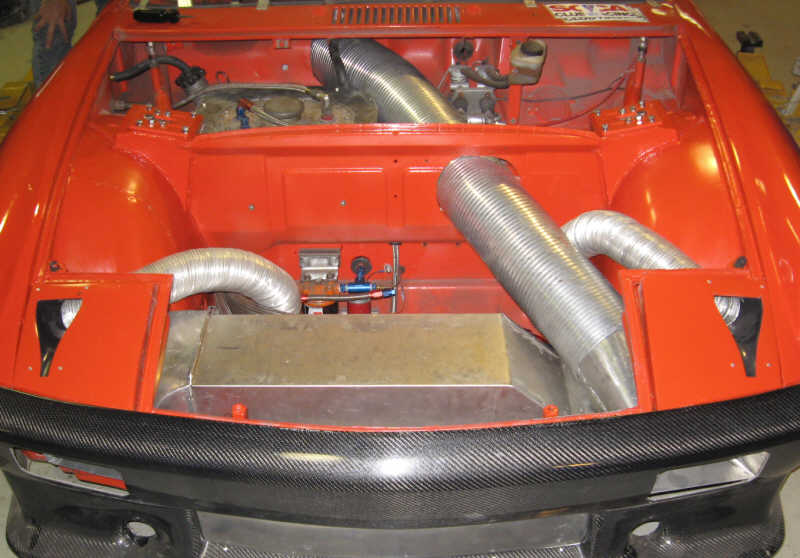

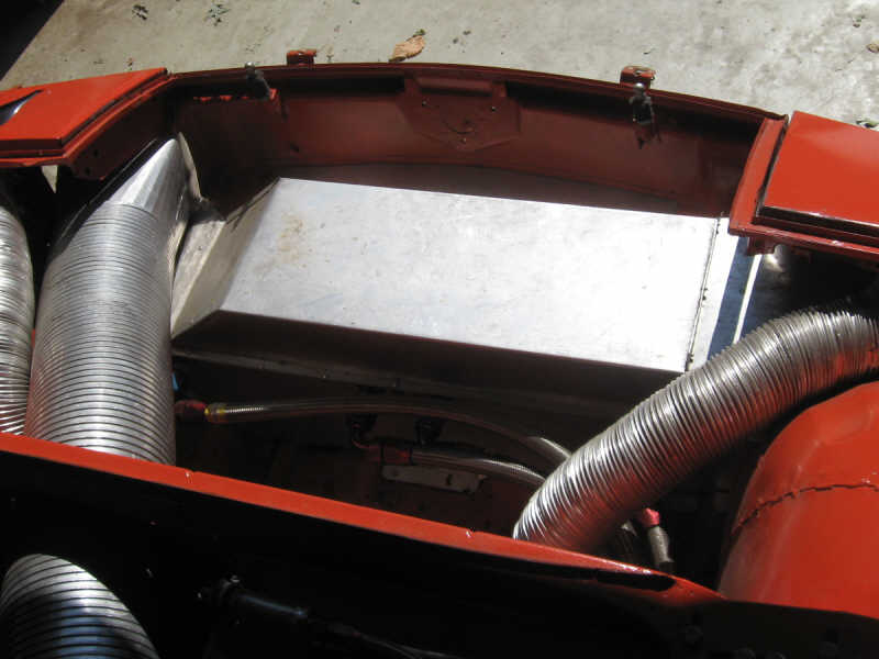

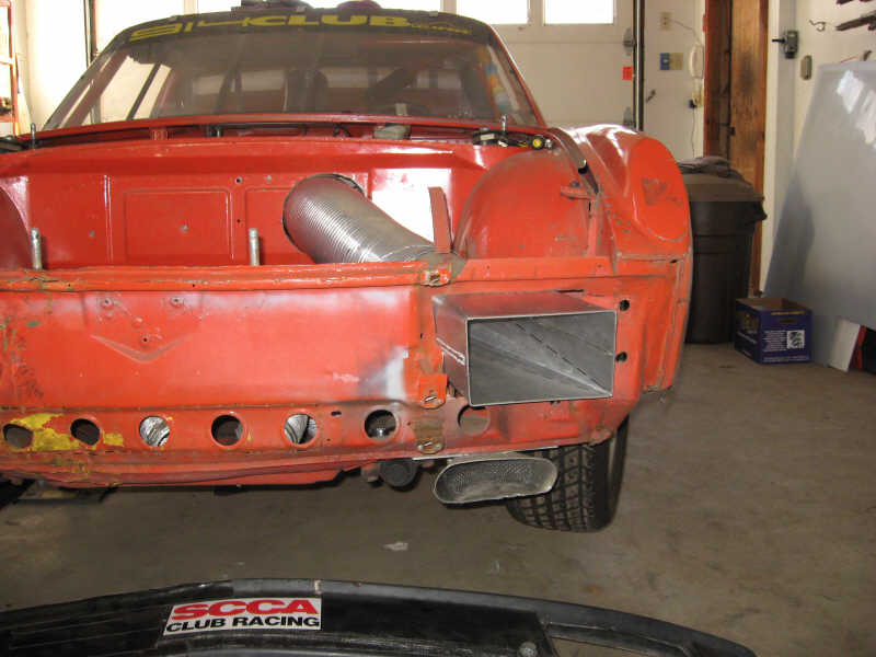

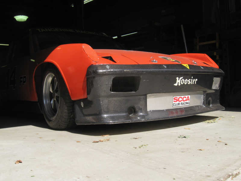

After the 2005 season I decided the Nationally competetive engine needed more fresh air to keep it cool.
Since the front end had been damaged at the Runoffs anyway, it was time for an upgrade. Every time I crash the car, I rebuild it better than before.
So after a couple years of thinking about it, in 2008 I made lots of changes to the car, with a goal of improving the cooling, aerodynamics, braking and handling all at the same time.

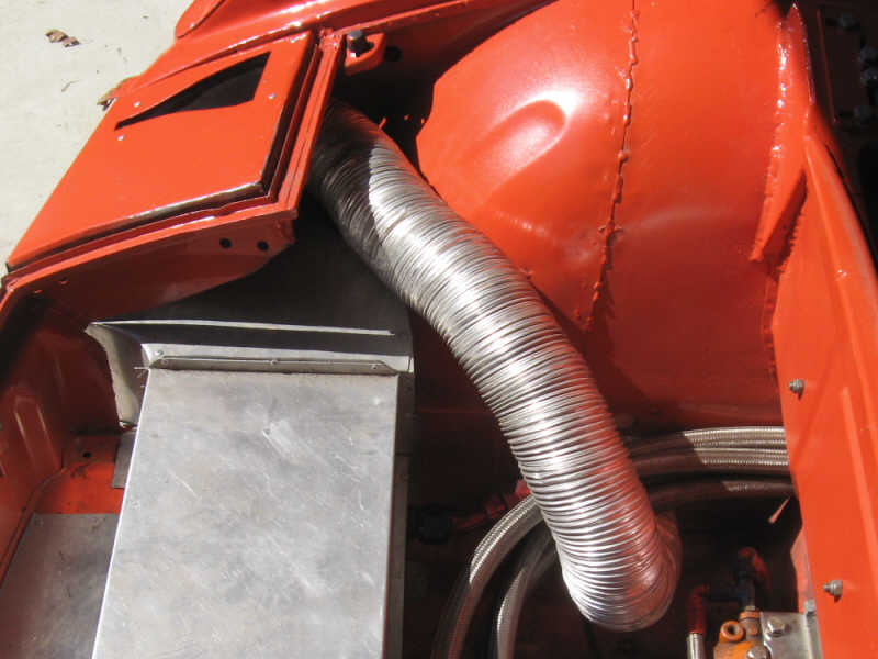

The oil cooler air ducting was completey revised.
The brake cooling ductwork was revised.
A new C/F nose was installed.
A 935 front suspension was installed with a bigger anti-sway bar.

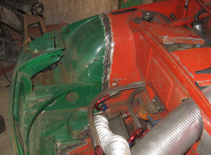

I replaced the right front corner of the chassis too since it was somewhat wrinkled.
Engine duct mockup:
Completed installation:
My primary engine has two oil pumps so there are two oil coolers inside this shroud.

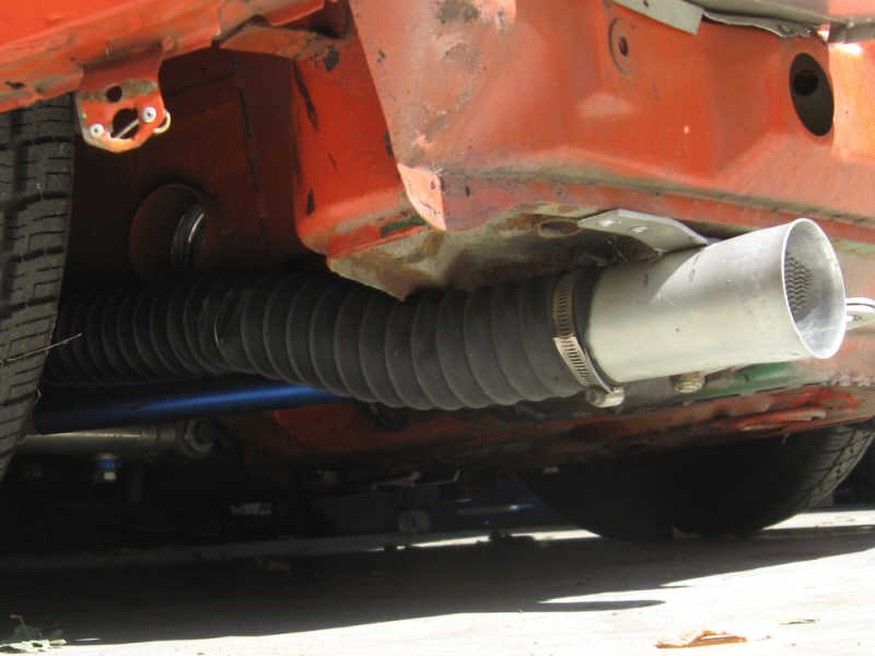

Primary brake duct inlet:

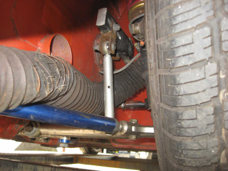

Secondary brake duct inlet:
The primary brake duct goes to the center of the rotor.
The secondary duct dumps fresh air at the caliper.
Chassis repair:

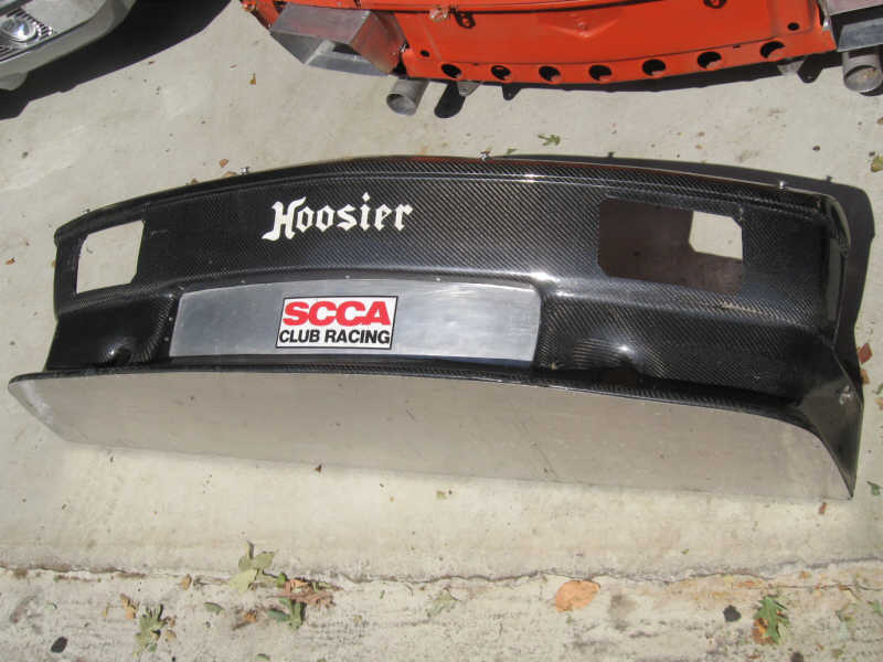

New nose:
and in the first race out I f'ed up the thousand dollar bumper/airdam (IMG:style_emoticons/default/headbang.gif)
