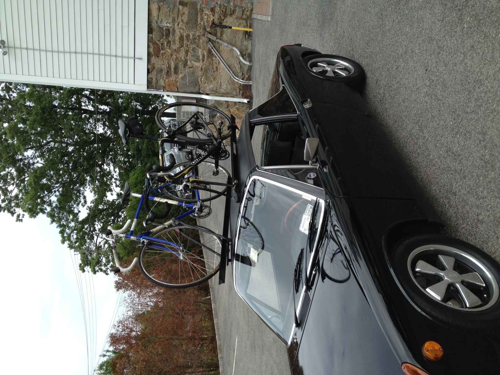

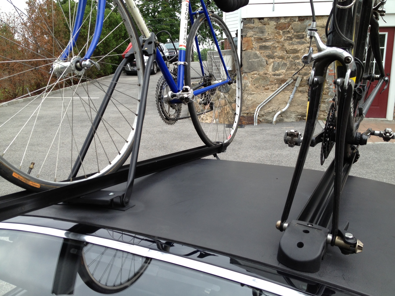

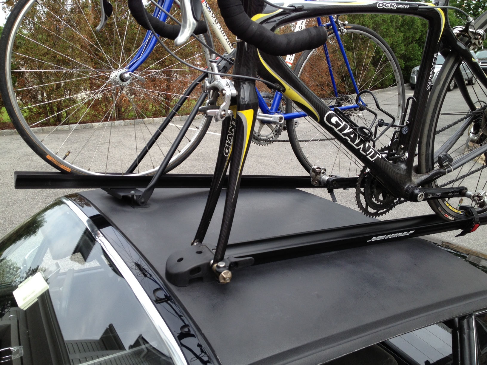

Added a second bike rack to my extra targa top. This one attaches to the front fork with the wheel off. Tested it and the entire unit seems stable ... we'll see how it holds up on a windy day!

mettelman   Added a second bike rack to my extra targa top. T...   Jun 26 2013, 02:00 PM
mettelman   look at the way it hold on a side hill!   Jun 26 2013, 02:05 PM
