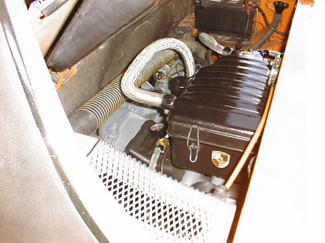

This is where I mounted my fuel pressure gauge within the engine. It works just fine.

PorscheTom   Along the lines fuel pressure gauges, how and wher...   Jul 15 2004, 10:58 AM
newdeal2   Just add one with a barbed T after the fuel pressu...   Jul 15 2004, 11:46 AM

newdeal2   Back to dave's comment. My pressure gauge was ...   Jul 15 2004, 06:26 PM
newdeal2   So what Dave is saying...now that I have read it a...   Jul 15 2004, 06:33 PM

SpecialK   This may explain what Dave is trying to "lay down"...   Jul 15 2004, 07:13 PM
newdeal2   The gauge was located just above the regulator in...   Jul 15 2004, 07:19 PM
SpecialK   Should work correctly then ;)   Jul 15 2004, 07:25 PM

Eric_Shea   One would think you could mount them in both locat...   Jul 16 2004, 02:19 PM
Eric_Shea   What kind of car is that Jim? :confused: :D ...   Jul 16 2004, 02:20 PM
mike_the_man   When I add one for adjusting or checking the fuel ...   Jul 16 2004, 04:11 PM
Dave_Darling   Mike, your understanding is correct. The "after t...   Jul 16 2004, 05:12 PM
Curvie Roadlover   Is that a steel braided hose from the airbox to th...   Jul 16 2004, 05:15 PM
