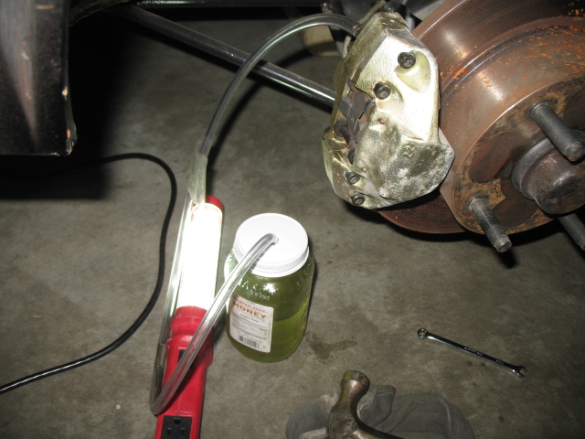

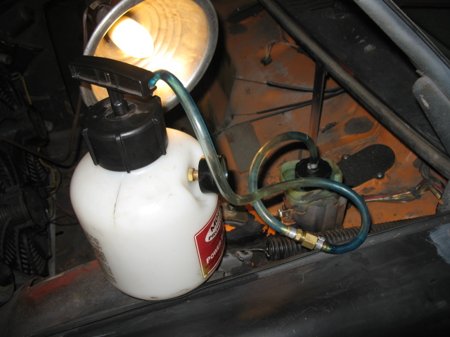

I am trying to bleed my bone dry brake system with a MOTIVE pressure system and a mix of long tube, but since they say you can't use SPEED BLEEDERS with MOTIVE, I want to make sure I am not chasing my tail.
I did bleed each corners twice so far and have some small amount of peddle, maybe 25% or so of normal.
the picture below is a new bleeder and one I pulled out of my jack standed car.

Black22   I'm no expert, but those don't look like S...   Sep 27 2013, 11:00 AM
stugray   You should be able to blow both ways through a nor...   Sep 27 2013, 11:07 AM
URY914   Did you google speedbleeders for a picture?   Sep 27 2013, 11:26 AM
jimkelly   I tried youtube. found this in google images but...   Sep 27 2013, 11:35 AM
wndsnd   These are speed bleeders Jim, I took them out cau...   Sep 27 2013, 11:35 AM
jimkelly   thanks for the pic : )   Sep 27 2013, 11:49 AM
jimkelly   think I will try the two person - old school style...   Sep 27 2013, 11:55 AM

andys   For a one-man operation, pressure bleeding or reve...   Sep 27 2013, 01:31 PM
SLITS   I use a Hospital Aspirator (vacuum pump). One thi...   Sep 27 2013, 01:54 PM
r_towle   bone dry system wont bleed unless you bench bleed ...   Sep 27 2013, 02:03 PM
jimkelly   I did crack the hard lines to the MC, but only for...   Sep 27 2013, 02:21 PM
r_towle   I did crack the hard lines to the MC, but only fo...   Sep 27 2013, 02:24 PM
jimkelly   to be certain - we are talking about cracking thes...   Sep 27 2013, 02:31 PM
shuie   yep, I've got the same issue. Lots of fluid an...   Sep 27 2013, 02:45 PM
jimkelly   this is where I saw it mentioned - the warning. h...   Sep 27 2013, 02:51 PM
