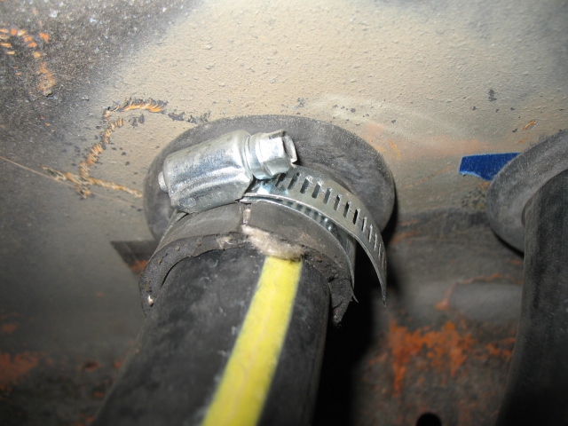

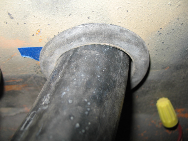

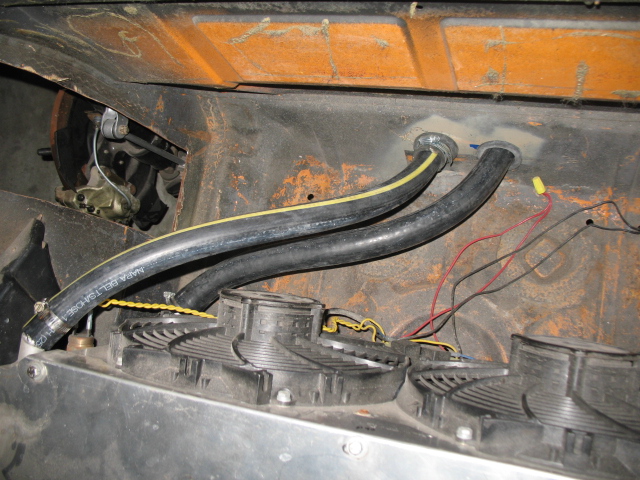

guess i'll run the coolant lines today. the 2" ID gommets will be fine. I was able to wrap the 1.5" OD hose fully with old hose, but the 1.75" OD does not leave a big gap but I will stuff some rubber in there.
