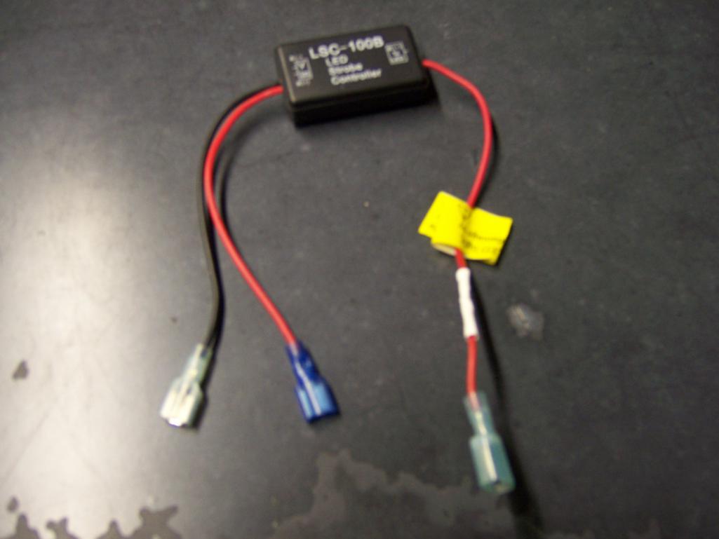

I added a $5 strobe flasher to my 3rd brake light set up, so now the 3rd brake light flashes in a pulsed manner. I bought the two models of the flasher module from superbrightleds.com, model LSC-100A and LSC-100B. LSC-100B gives you continuous flash pulsing as you step on brake. LSC-100A gives a few strobe pulses then brake lite stays on solid. I put on push-terminals so I when my mood strikes, I can change the mode of the flashing. Sorry, I don't know how to attach a video file of the actual light flashing. You will have to look up a youtube search at the vendor website using the model numbers discussed above and you will get an idea of the flashing mode outputs. (IMG:style_emoticons/default/smile.gif) I added a fuse assembly as well. Wiring is simple, two grounds off of the left terminal, the hot terminal off of the the light housing feeds the strobe unit black lead, and the red lead exiting the strobe unit connects to the hot feed to the 3rd brake light. Attached Image Attached Image
