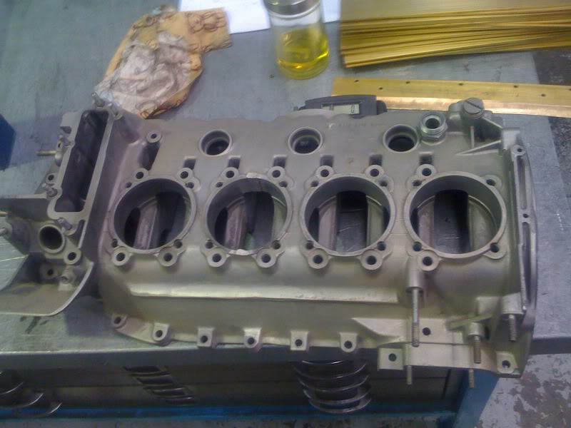

Any Takers here?
Quote
Flat 8 Porsche Engine
A mate is making a flat 8 engine for a replica 908. He has used two 2.7lt magnesium blocks that we wirecut at my work and has welded them together in a jig. First time he has welded mag and it is a steep learning curve with the pre heating/jigging and post stress relieving. Here are the photos of his second attempt. He still has 1mm of bend after welding but is making a different jig that will be stronger and keep the heat more stable (he was saying 5 mins after welding and it was cool enough to handle).
Unquote
http://performanceforums.com/forums/showth...-Porsche-Engine
from '11
