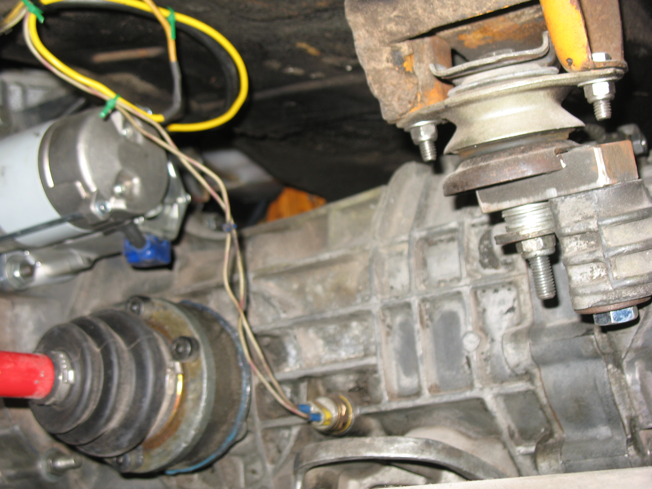

hooked up ignition to starter wire and reverse lights wire to trans.

jimkelly   since the only electrical connector I have, that h...   Sep 30 2013, 07:32 AM

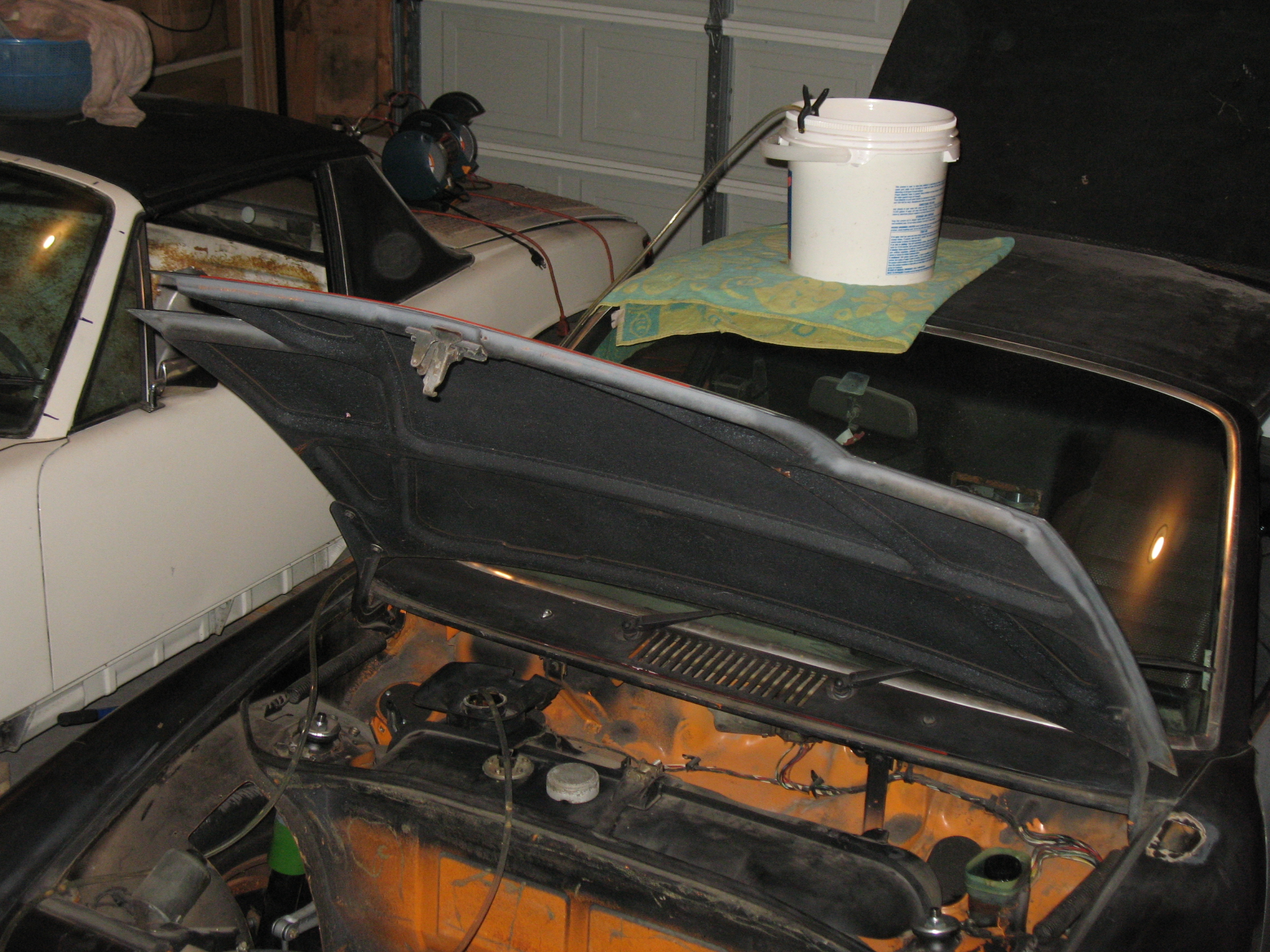

jimkelly   yesterday... filled cooling system with water, spl...   Oct 21 2013, 01:32 PM
