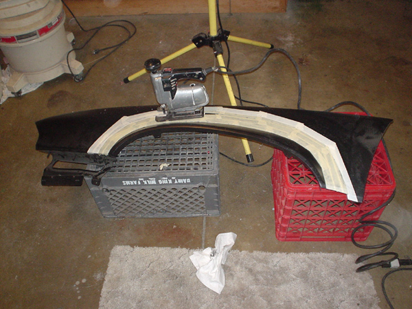

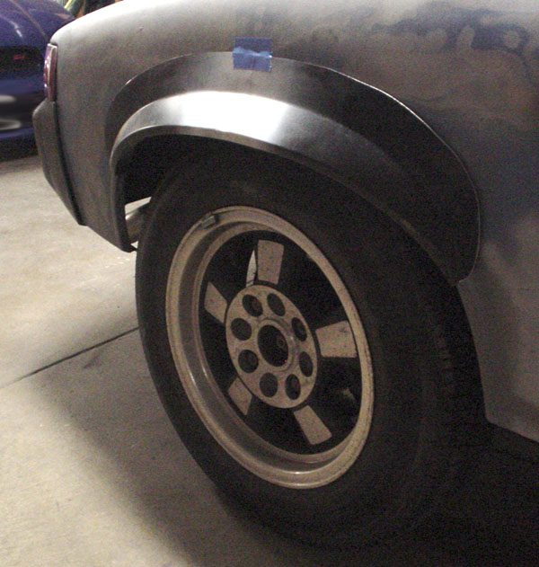

A few years ago, I made these from the front fenders of a 91 Pontaic Grand Prix. I bought them new and I recall thet they were inexpensive. Never did get them on the car...
They were too long, so after I cut out the flare, I shortened it by taking aout about a 1.5" piece put of the middle. Looks like a good fit same squarish shape as the 914 fenders and the same width edge. Depends on how you fit them, you will get 215 under them for sure, and maybe 225s.
