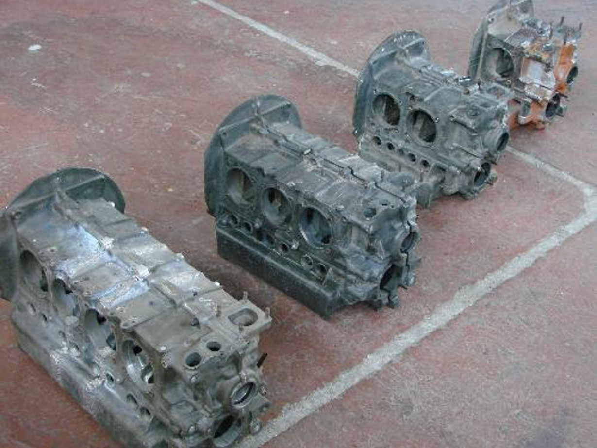

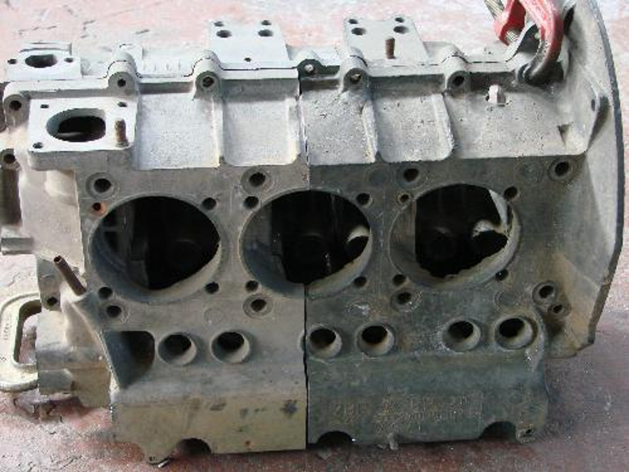

OK.here's the plan..
Get 2 sets of cases,and weld them together after machining the front and rear off each respective set.
Front 2 and rear 2.Makes a long case to carry 8 cylinders.
Look,if the guy in Aus can weld magnesium cases,it would have to be easier to do the same to 356 T6 alloy cases.
Marginally easier admittedly,but possible to achieve the exalted F-8.
Fun with TIG,in an oven,inert gas flushed...

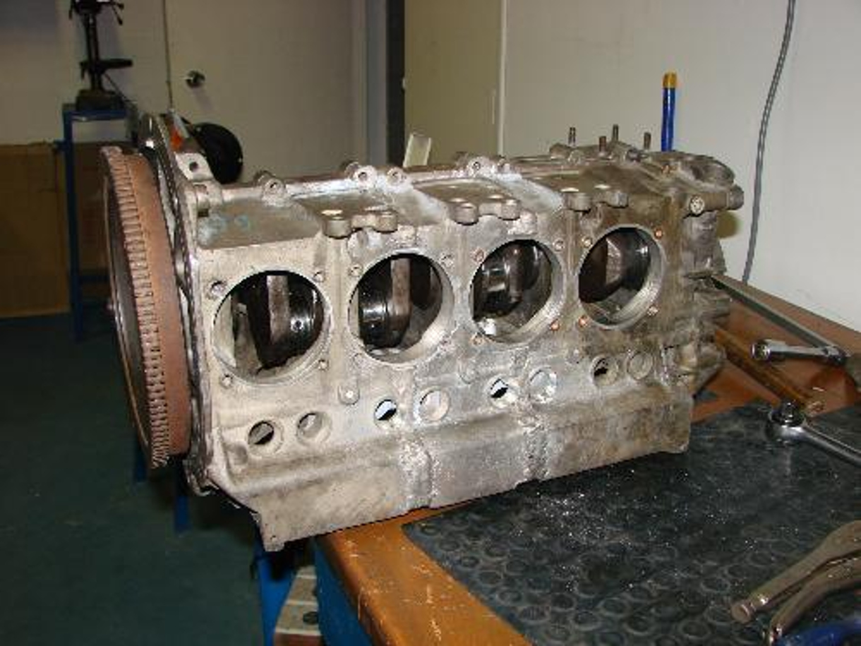

Well,the fellow in Australia has the right idea,wire edm cutting the cases to key each other together.
Still,tubular shafts,ground to the mains and cam dia +0.0004"/-0 for alignment is essential.
Otherwise,a near hopeless adventure,preparation of the weld groove is critical,minimum weld added.
Tough job,all around.For sure a worthy aspiration,wanting -8,pushrod even.More cylinders,more better.

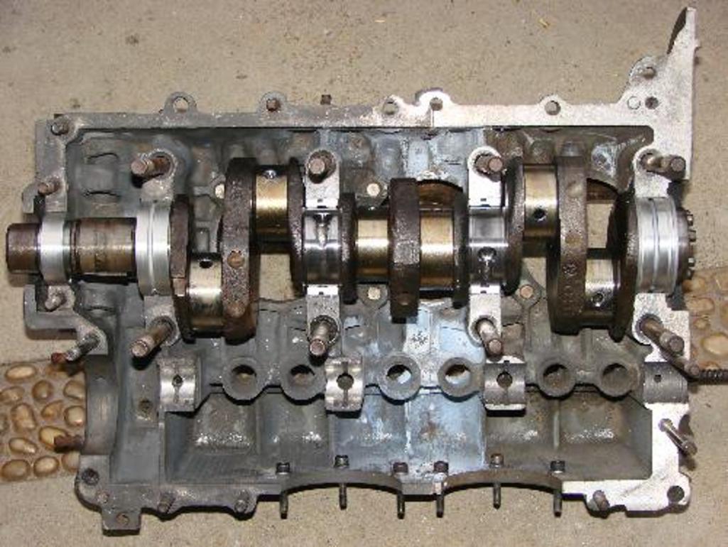

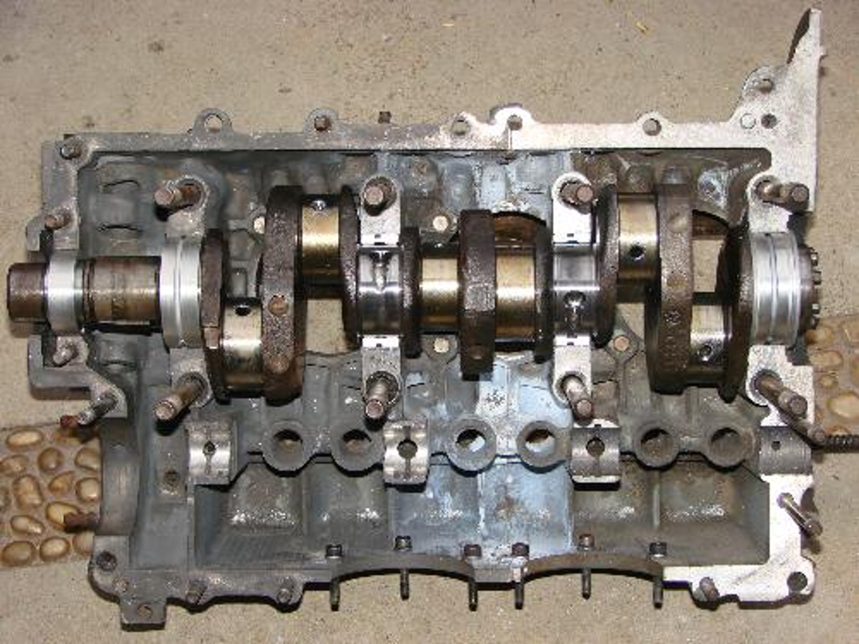

A VW Boxer Six,a neato version of the Corvair engine.
Clearly,a welded crank.Note the main journal's discoloration and heat affected zone.
The -8 crank is done in a similar way,two -4 cranks welded together,90* apart.

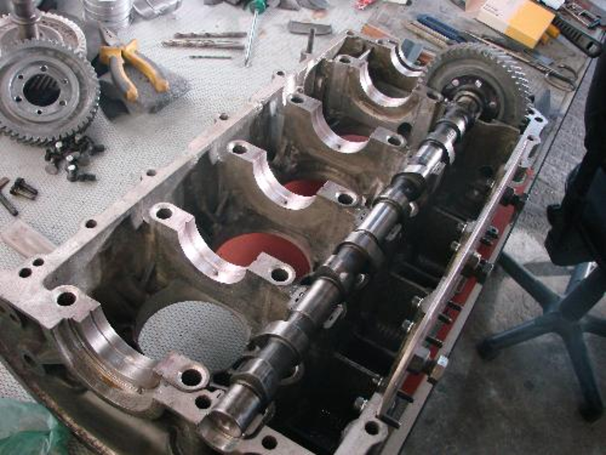

Some real expertise demonstrated here,kudos.Note the cam nose profiles,long duration,mushroom lifters,a revver.
