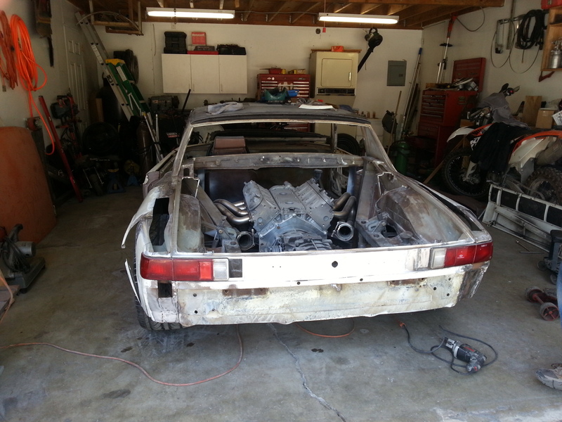

Hmmm...
Couldn't find the thd,What sitename?
Lower longer..starting to look like a Can-Am with a 914 house on top.
Hey,it does have a Can-Am engine.+Turbos!
The large vents under the trunk floor will allow the flow of the massive heat generated by the powerplant,feeding the low pressure area behind the car at speed.Turbulent air under the car is drawn out.
The width here is about as extreme as it should get.
Still possible to add GT flares of narrower dimension.
The reverse light is in factory position,the lens is merely wider by the widening amount.
Not the easy way this is.You would need a metal surgeon to hammer and dolly the added strips of sheetmetal.The shape of the trunkline rear of the targa defines the intersecting transverse curve.The beltline then is lower.Raising the trunkline would help a lot,giving a humpier,bulging curve to the rear top quarter,sorto like the latemodel Aston-Martins.
The focal length of the camera used foreshortens the image making it tricky to accurately sketch.
Wider than the section cut.+2"
Primordial DNA of the 914 Targa Bar.
