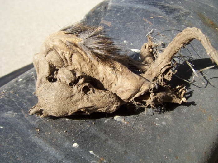

Okay so the saturday of Route 66. I woke up for the drive to find a new smell in my car. Wasn't to bad that day but has gotten progressively worse. I can't find the son of bitch anywhere. Try following my nose & that doesn't work. I cannot pinpoint where the smell is coming from. I've left the top off my car & the windows down in my garage. Figured eventually the decomp would be done. Trying to air it out & it does not seem to be getting any better. I've even had my kids come out to smell & try to find the source. I've taken a mini camera deal to get into all the places I can't see. I've found nothing (IMG:style_emoticons/default/headbang.gif) I've looked under the seats, behind the backpad, in my vents, in the tubes in the long, under the dash, in both trunks, all around the gas tank. I'm at a loss (IMG:style_emoticons/default/sad.gif) . When the smell is obvious & when driving it circulates the air making it worse. (IMG:style_emoticons/default/WTF.gif) Looking for ideas to find it. I'm not going to smell that (IMG:style_emoticons/default/stromberg.gif) going to WCR & back

Eric_Shea   Jack tubes? :confused: I'd pull the tank. The...   May 1 2014, 09:45 AM

boxsterfan   Try pulling of the heater tube hoses that go from ...   May 1 2014, 10:44 AM

SirAndy   I had a rodent crawl into the heater tubes and die...   May 1 2014, 11:11 AM
ClayPerrine   I had a rodent crawl into the heater tubes and di...   May 1 2014, 01:08 PM
914_teener   Pack Rat in the heater tube.....imo   May 1 2014, 11:12 AM

stugray   Under the gas tank is an access hole (from beneath...   May 1 2014, 11:55 AM

JRust   I think it may be in the passenger long. Just weir...   May 1 2014, 06:40 PM

JRust   It was definitely in the passenger long heater tub...   May 8 2014, 09:59 AM
Kansas 914   It was definitely in the passenger long heater tu...   May 8 2014, 10:02 AM
Mike Bellis   That shit you see in there was completely packed...   May 8 2014, 10:27 AM

Moneypit   So, any bones? You thinking this was a living thin...   May 8 2014, 10:11 AM
7TPorsh   how does that happen overnight?   May 8 2014, 10:37 AM
JRust   how does that happen overnight? It wasn't ov...   May 8 2014, 01:51 PM

relentless   Once you get all you can out of the long, you migh...   May 8 2014, 01:59 PM

sixnotfour   flush it with water hose...then some simple green ...   May 8 2014, 05:30 PM

JRust   Made a little attachment from my shop vac to make ...   May 9 2014, 11:43 AM
