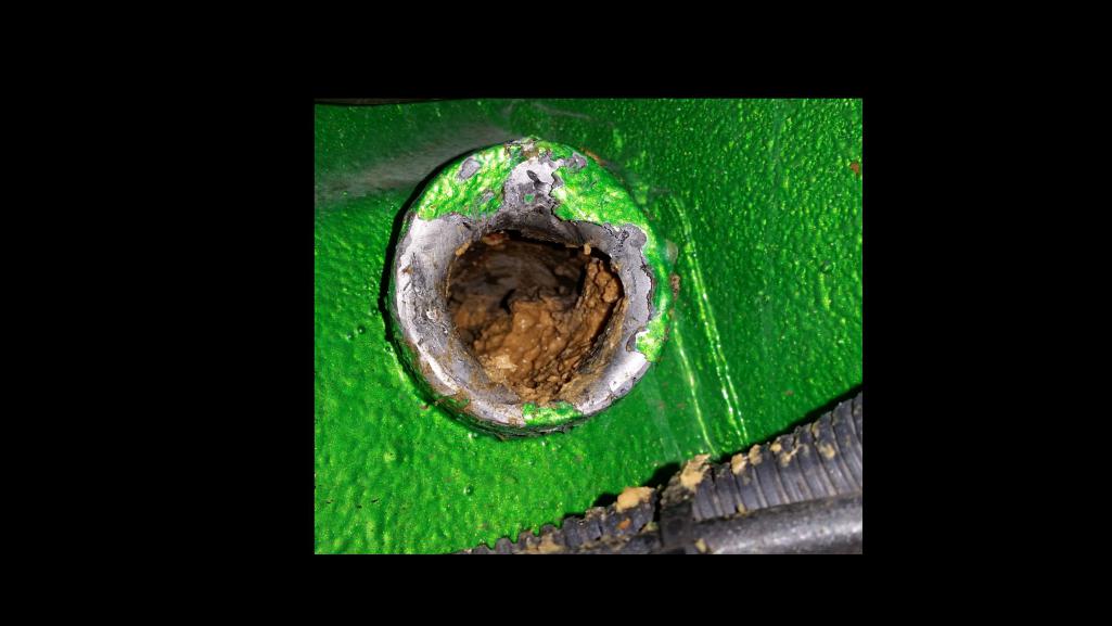

Okay so the saturday of Route 66. I woke up for the drive to find a new smell in my car. Wasn't to bad that day but has gotten progressively worse. I can't find the son of bitch anywhere. Try following my nose & that doesn't work. I cannot pinpoint where the smell is coming from. I've left the top off my car & the windows down in my garage. Figured eventually the decomp would be done. Trying to air it out & it does not seem to be getting any better. I've even had my kids come out to smell & try to find the source. I've taken a mini camera deal to get into all the places I can't see. I've found nothing (IMG:style_emoticons/default/headbang.gif) I've looked under the seats, behind the backpad, in my vents, in the tubes in the long, under the dash, in both trunks, all around the gas tank. I'm at a loss (IMG:style_emoticons/default/sad.gif) . When the smell is obvious & when driving it circulates the air making it worse. (IMG:style_emoticons/default/WTF.gif) Looking for ideas to find it. I'm not going to smell that (IMG:style_emoticons/default/stromberg.gif) going to WCR & back

It was definitely in the passenger long heater tube. Of course that was the one that had a cap welded over it. Pain in the ass to get at. I was able to barely get in there with my drill. Drilled a 3/4" hole as that was the biggest metal bit I had. Pulled the bit out & it was packed with shit. The hole was instantly covered with the sludge. I don't know what the hell it was. The fluid/gunk in there was just so nasty. Had a hard time not puking. The picture below is after I had drilled a couple holes. Then used a pipe to make a big enough hole to get my shop vac hose in there. So this pic is after I had vacuumed what I could. That shit you see in there was completely packed in the tube (IMG:style_emoticons/default/icon8.gif)

Eric_Shea   Jack tubes? :confused: I'd pull the tank. The...   May 1 2014, 09:45 AM
boxsterfan   Mouse died in the longs?   May 1 2014, 09:45 AM
JRust   Mouse died in the longs? I looked in the longs w...   May 1 2014, 10:39 AM

boxsterfan   Try pulling of the heater tube hoses that go from ...   May 1 2014, 10:44 AM
JRust   Try pulling of the heater tube hoses that go from...   May 1 2014, 10:51 AM

SirAndy   I had a rodent crawl into the heater tubes and die...   May 1 2014, 11:11 AM
ClayPerrine   I had a rodent crawl into the heater tubes and di...   May 1 2014, 01:08 PM
914_teener   Pack Rat in the heater tube.....imo   May 1 2014, 11:12 AM

JRust   I think it may be in the passenger long. Just weir...   May 1 2014, 06:40 PM
Kansas 914   I think it may be in the passenger long. Just wei...   May 1 2014, 06:42 PM

sixnotfour   mice can go from center tunnel to longs...or heate...   May 1 2014, 08:20 PM

JRust   It was definitely in the passenger long heater tub...   May 8 2014, 09:59 AM
Kansas 914   It was definitely in the passenger long heater tu...   May 8 2014, 10:02 AM

Moneypit   So, any bones? You thinking this was a living thin...   May 8 2014, 10:11 AM
7TPorsh   how does that happen overnight?   May 8 2014, 10:37 AM
JRust   how does that happen overnight? It wasn't ov...   May 8 2014, 01:51 PM

relentless   Once you get all you can out of the long, you migh...   May 8 2014, 01:59 PM

sixnotfour   flush it with water hose...then some simple green ...   May 8 2014, 05:30 PM

JRust   Made a little attachment from my shop vac to make ...   May 9 2014, 11:43 AM
tomeric914   After that I'll get some por 15 or something ...   May 10 2014, 08:03 PM
effutuo101   They make a spray to coat the inside of tubes. You...   May 9 2014, 11:51 AM
r_towle   have you looked in from the front of that tube beh...   May 9 2014, 11:52 AM
Kansas 914   have you looked in from the front of that tube be...   May 9 2014, 12:03 PM
JRust   have you looked in from the front of that tube b...   May 9 2014, 01:31 PM

r_towle   Are you using the heater tubes? If not, I might s...   May 9 2014, 04:51 PM
Mike Bellis   You could get a water jet fitting on a garden hose...   May 10 2014, 11:39 AM
JRust   You could get a water jet fitting on a garden hos...   May 12 2014, 10:20 AM
Kansas 914   So saturday I did this. Put a high pressure nossl...   May 12 2014, 10:27 AM
