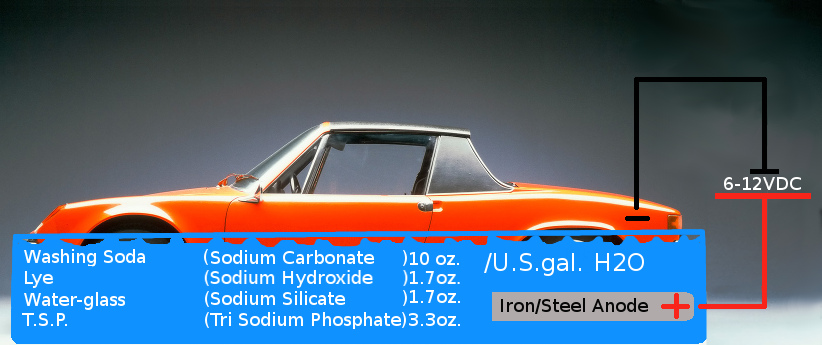

veekry9 NKZv14-K71g
http://www.instructables.com/id/Elect... Nov 10 2014, 11:52 PM
veekry9 v7TnNEBy3tI
Amazing! Nov 11 2014, 12:01 AM
veekry9 4QrLCGVVjzg
Anyone try this?
Q8Xo43sfLgY
D-cell... Nov 11 2014, 12:05 AM
