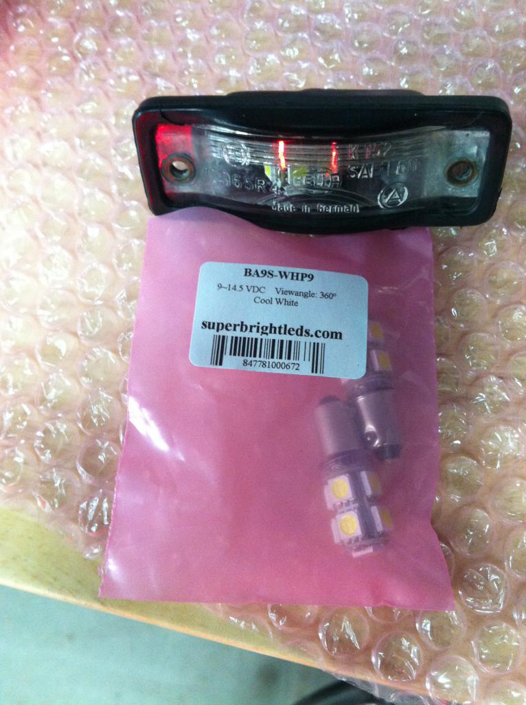

(3) License Plate Lights and Rear Trunk Light bulbs – Cool White [BA9S-WHP9] $9.95
https://www.superbrightleds.com/moreinfo/ba.../#/attributes/1
Left side is the old bulb, new LED on right

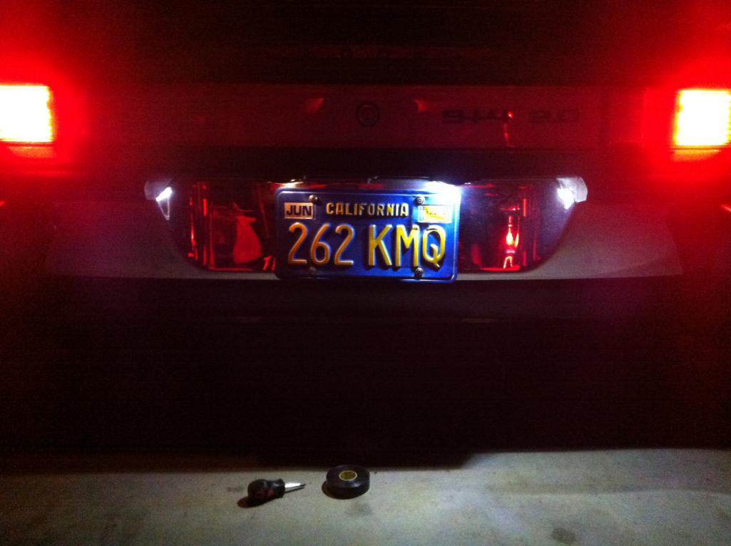

eric9144   Other photos for reference... Note brightness of ...   Mar 13 2015, 03:11 PM
eric9144   Front complete with Spoke's LED boards:   Mar 13 2015, 03:13 PM
eric9144   Rear of car complete: :headbanger: The picture...   Mar 13 2015, 03:14 PM
