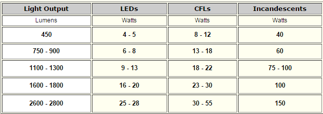

Curious question to electrical engineers out there: how much does having all LEDs change the load on the circuits, battery, and alternator?
Will all LEDs benefit my old car by putting less stress on the 55amp system? (IMG:style_emoticons/default/shades.gif)
In short, Yes (IMG:style_emoticons/default/beerchug.gif)
The LED bulbs are far more efficient in terms of overall draw and service life vs the OE incandescent bulbs we were running. I can't quantify the overall change in power load, but I can tell you that my idle used to change (drop) when I pulled the headlight switch on...it doesn't any more!
This info is geared towards home lighting solutions but you can see how dramatic the differences are in terms of draw:
There are other benefits as well--longer life, not sensitive to humidity, less sensitive to heat/cold, and low heat generation (i.e. they dont typically get "hot")
