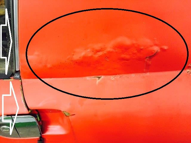

It's good you're passing on the red car if you don't have strong repair skills.
Just FYI if you poked these bubbles with a screwdriver it would most likely go right through the panel. Also note that the door does not seem to line up correctly. It might not be fully closed but if it's hard to close that's an indication that the body is sagging. That is the driver's side, which is not normally as bad as the passenger side. Once it starts sagging...major repair.
