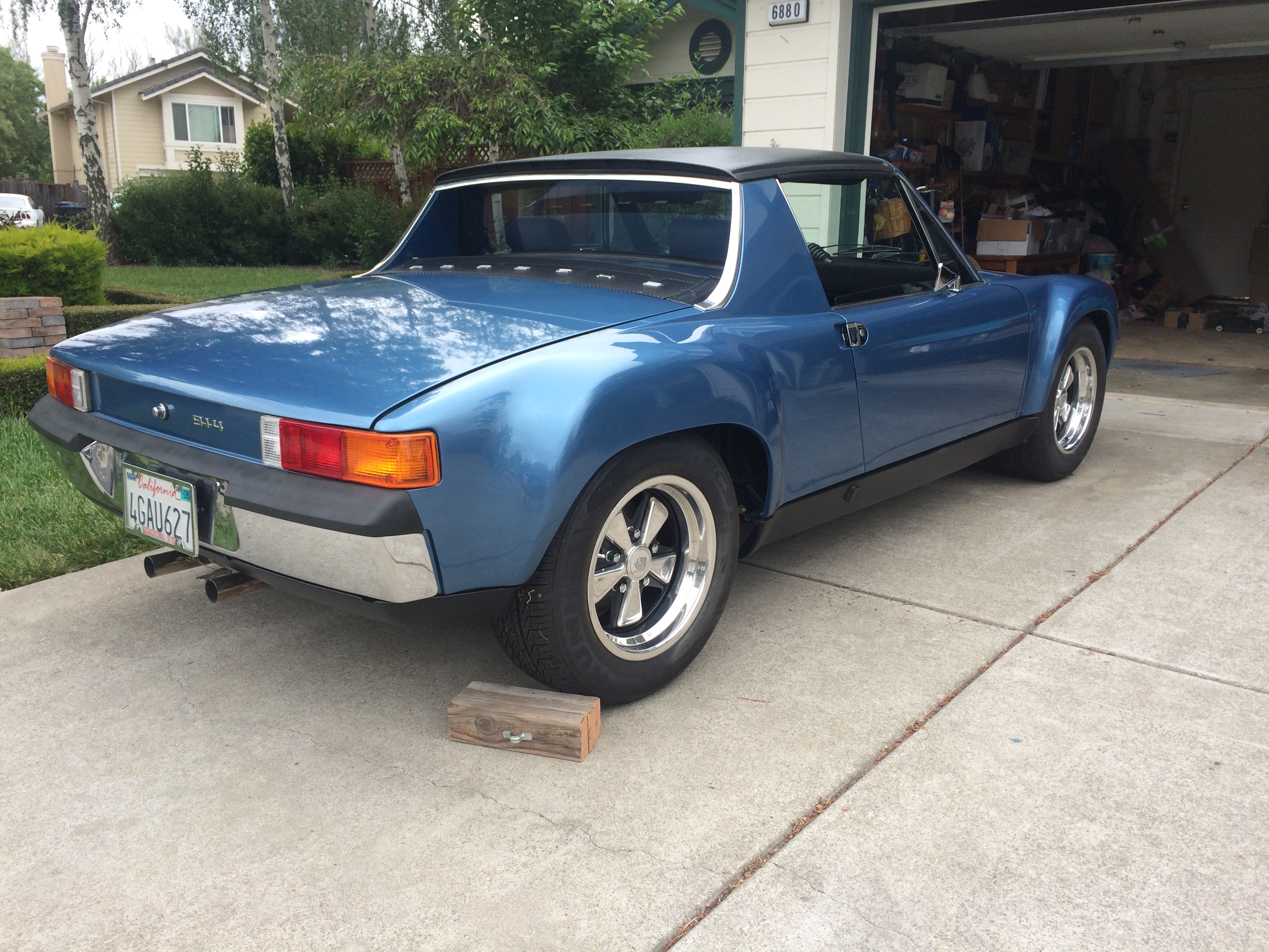

It's been nearly a life long dream to have a GT. I've got an absolutely great car and with the exception of a narrow body, I'd be content. So, I'll add some more content later but the basic question is how do I go wide?
Attached Image Attached Image Attached Image Attached Image Attached Image Attached Image Attached Image Attached Image Attached Image
