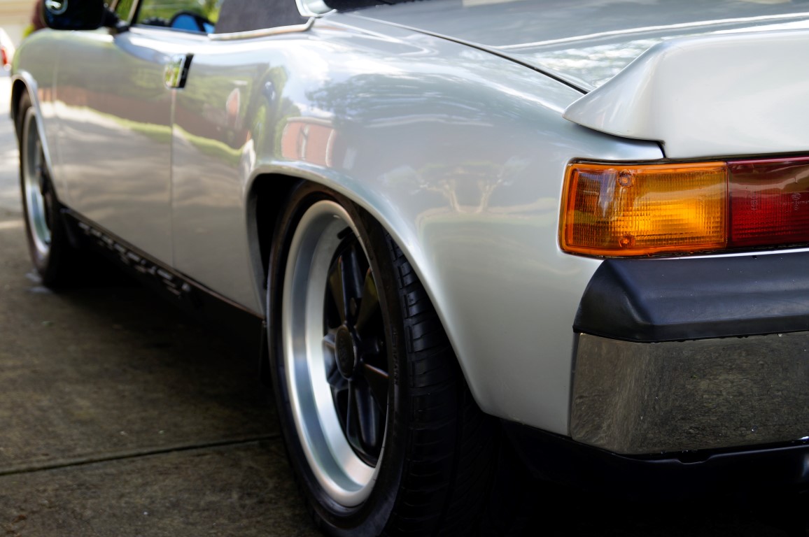

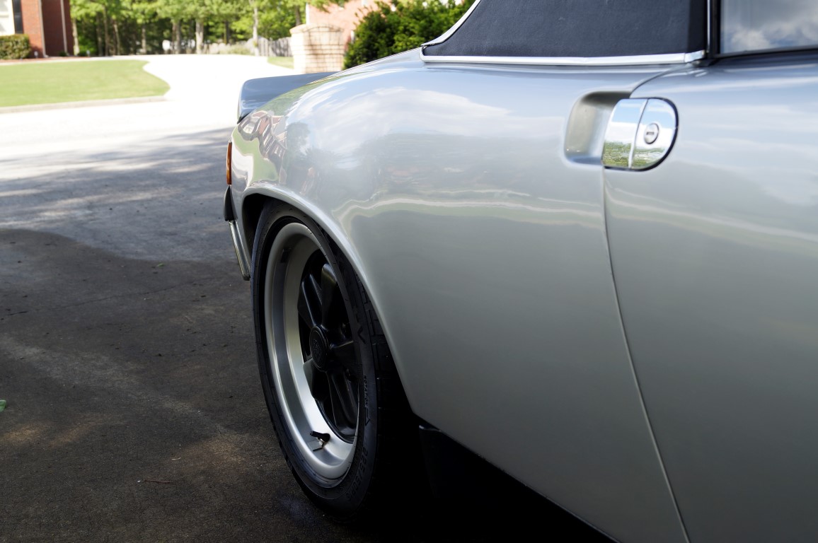

These flares were created by slicing and adding in a bit of metal and then finishing them inside and out. I can get 9x16 Fuchs under them.

db9146   These flares were created by slicing and adding in...   Aug 7 2016, 05:12 PM
Mark Henry   These flares were created by slicing and adding i...   Aug 7 2016, 05:31 PM
Reverend Troublemaker   Nicely done. T These flares were created by sl...   Aug 7 2016, 05:57 PM

My 914   That's a nice look, subtle but distinct. The ...   Aug 7 2016, 07:00 PM
