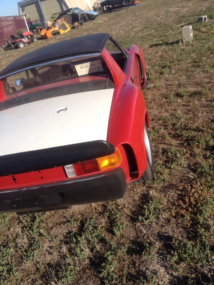

It's been nearly a life long dream to have a GT. I've got an absolutely great car and with the exception of a narrow body, I'd be content. So, I'll add some more content later but the basic question is how do I go wide?
Attached Image Attached Image Attached Image Attached Image Attached Image Attached Image Attached Image Attached Image Attached Image

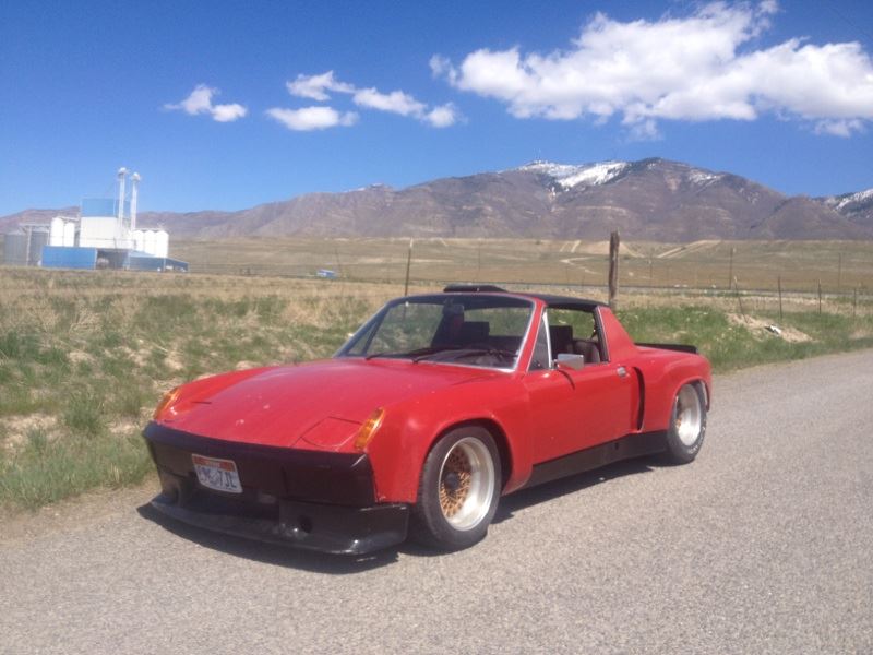

db9146   These flares were created by slicing and adding in...   Aug 7 2016, 05:12 PM
Mark Henry   These flares were created by slicing and adding i...   Aug 7 2016, 05:31 PM
Reverend Troublemaker   Nicely done. T These flares were created by sl...   Aug 7 2016, 05:57 PM

My 914   That's a nice look, subtle but distinct. The ...   Aug 7 2016, 07:00 PM
