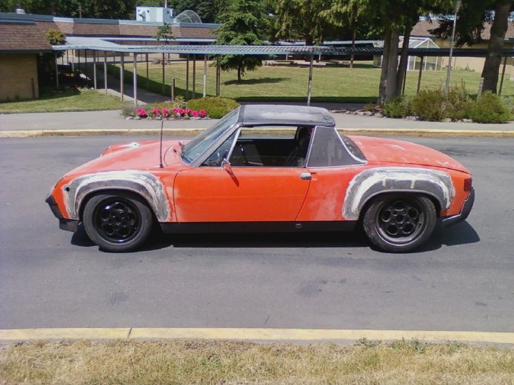

It's been nearly a life long dream to have a GT. I've got an absolutely great car and with the exception of a narrow body, I'd be content. So, I'll add some more content later but the basic question is how do I go wide?
Attached Image Attached Image Attached Image Attached Image Attached Image Attached Image Attached Image Attached Image Attached Image

914 fender tip outs 7/8s

Rand   Tony cracker, I love you man. Your dad is looking ...   Aug 6 2016, 08:10 PM
Chris914n6   You're looking at about $1500 for flare b...   Aug 6 2016, 08:16 PM
Elliot Cannon   Fiberglass with "dzus" fasteners. Unles...   Aug 6 2016, 11:58 PM
mepstein   If you have a good car, flare it. There is no reas...   Aug 7 2016, 08:00 AM

Tom_T   Hey Ben, Contrary to the "I love 914-GT Flar...   Aug 7 2016, 11:01 AM

db9146   These flares were created by slicing and adding in...   Aug 7 2016, 05:12 PM
Mark Henry   These flares were created by slicing and adding i...   Aug 7 2016, 05:31 PM
Reverend Troublemaker   Nicely done. T These flares were created by sl...   Aug 7 2016, 05:57 PM

Krieger   Live your dream! Go steel and have them welde...   Aug 7 2016, 11:24 PM

sixnotfour   Haters........10 up front 12 rear german steel fl...   Aug 8 2016, 09:39 AM

ben*james   Well - I'm very thankful for the comments you ...   Aug 8 2016, 08:54 PM

JRust   I am not sure if Jerry Mahoney is still doing body...   Aug 8 2016, 09:12 PM
ben*james   I am not sure if Jerry Mahoney is still doing bod...   Aug 9 2016, 09:23 AM
sixnotfour   9.5 and 10.5 911 rsr style fenders :sawzall: :wel...   Aug 8 2016, 10:36 PM

Mark Henry   If you want to see flares done right here's th...   Aug 9 2016, 10:06 AM
