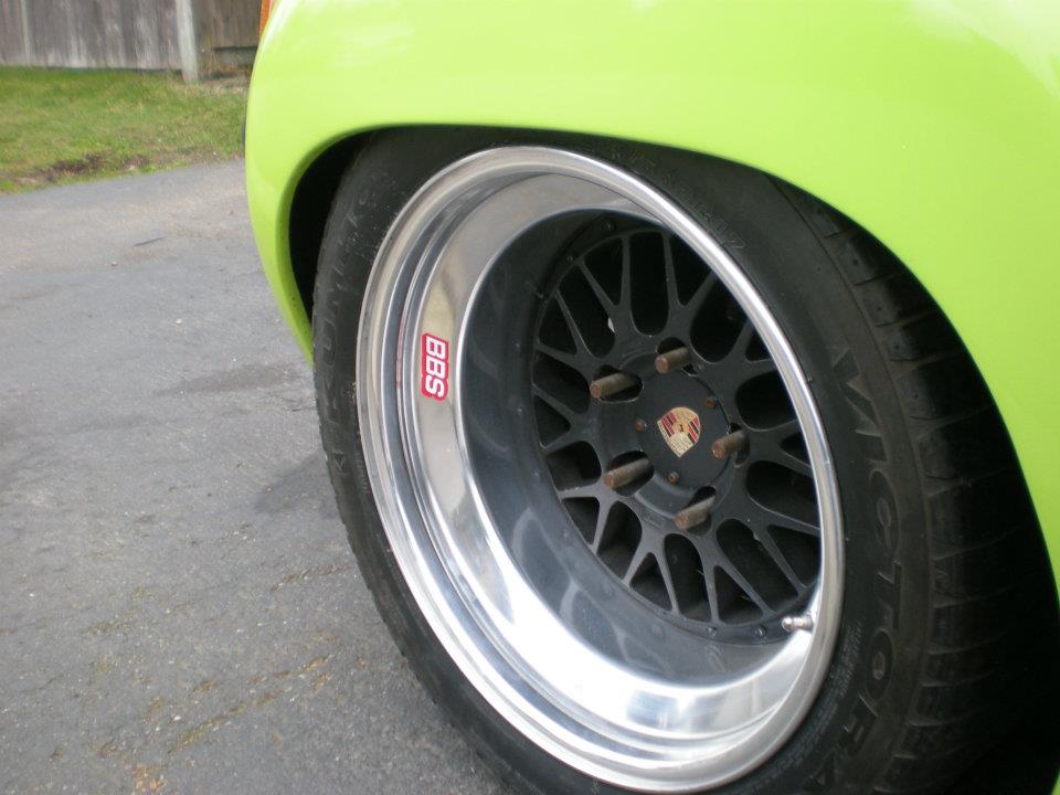

sixnotfour   roll fatties 15x9 245/50-15 tight on standard GT...   Aug 9 2016, 01:16 PM
