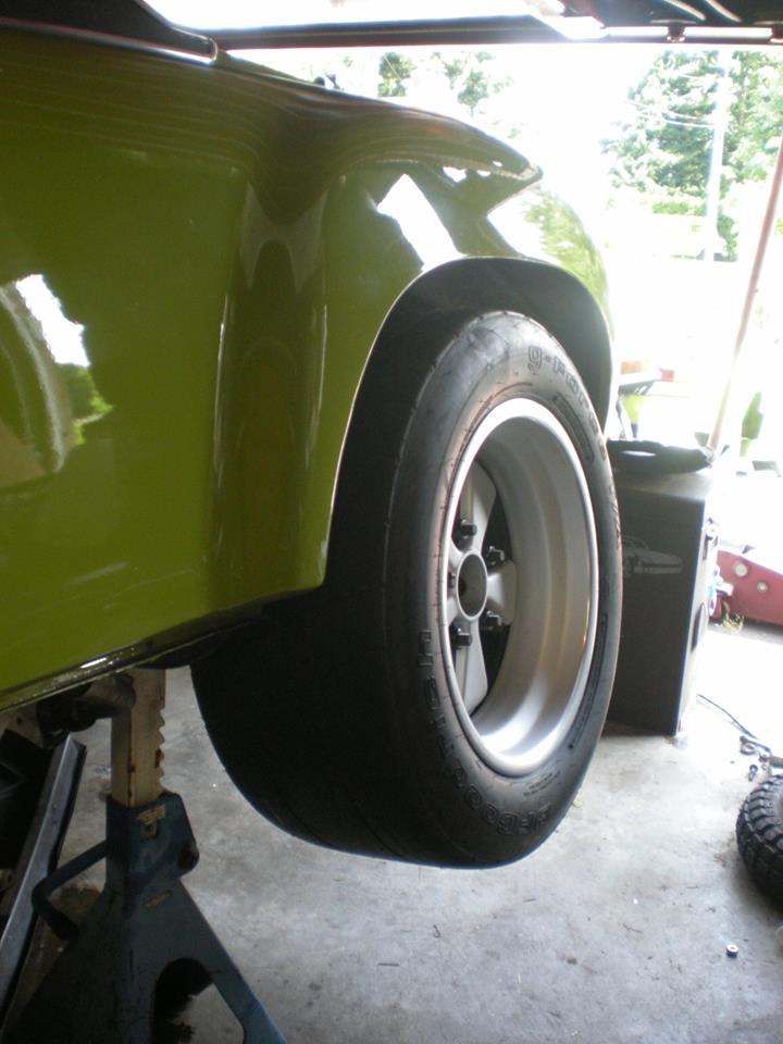

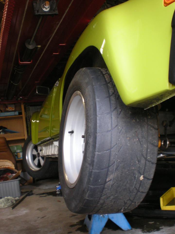

It's been nearly a life long dream to have a GT. I've got an absolutely great car and with the exception of a narrow body, I'd be content. So, I'll add some more content later but the basic question is how do I go wide?

15x9 245/50-15 tight on standard GT flairs .get your tires wheels first..

db9146   These flares were created by slicing and adding in...   Aug 7 2016, 05:12 PM
Mark Henry   These flares were created by slicing and adding i...   Aug 7 2016, 05:31 PM
Reverend Troublemaker   Nicely done. T These flares were created by sl...   Aug 7 2016, 05:57 PM
mepstein   If you stick with Fuchs the 7 & 8's will w...   Aug 7 2016, 05:54 PM

sixnotfour   Haters........10 up front 12 rear german steel fl...   Aug 8 2016, 09:39 AM

sixnotfour   9.5 and 10.5 911 rsr style fenders :sawzall: :wel...   Aug 8 2016, 10:36 PM
