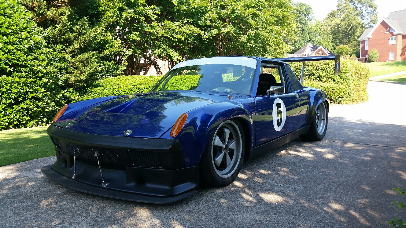

It's been nearly a life long dream to have a GT. I've got an absolutely great car and with the exception of a narrow body, I'd be content. So, I'll add some more content later but the basic question is how do I go wide?

Obviously, there are a few options and what you end up choosing will probably be based upon your budget and time frame (and whether you can/want to do the work too). Definitely use your current car...do you have the skills, time and equipment to install flares yourself?
I have had both glass (I installed - riveted) and currently have steel - I like both but prefer the steel. The down side is that a full exterior paint is most likely necessary or at least easier when finished. Mo-money, mo time.
Glass can be installed and paint matched fairly easily. It took me about 30 hours to hand fit each panel (total time! LOL). The devils in the details to make a glass car look outstanding - fit & finish wise.
Best of luck!
PS: I do like blue..
Tony
STEEL
GLASS (Lewis Broyles - Friend who helped quite a bit on this build)
whitetwinturbo

That wing.........cool. Where can I get one?
