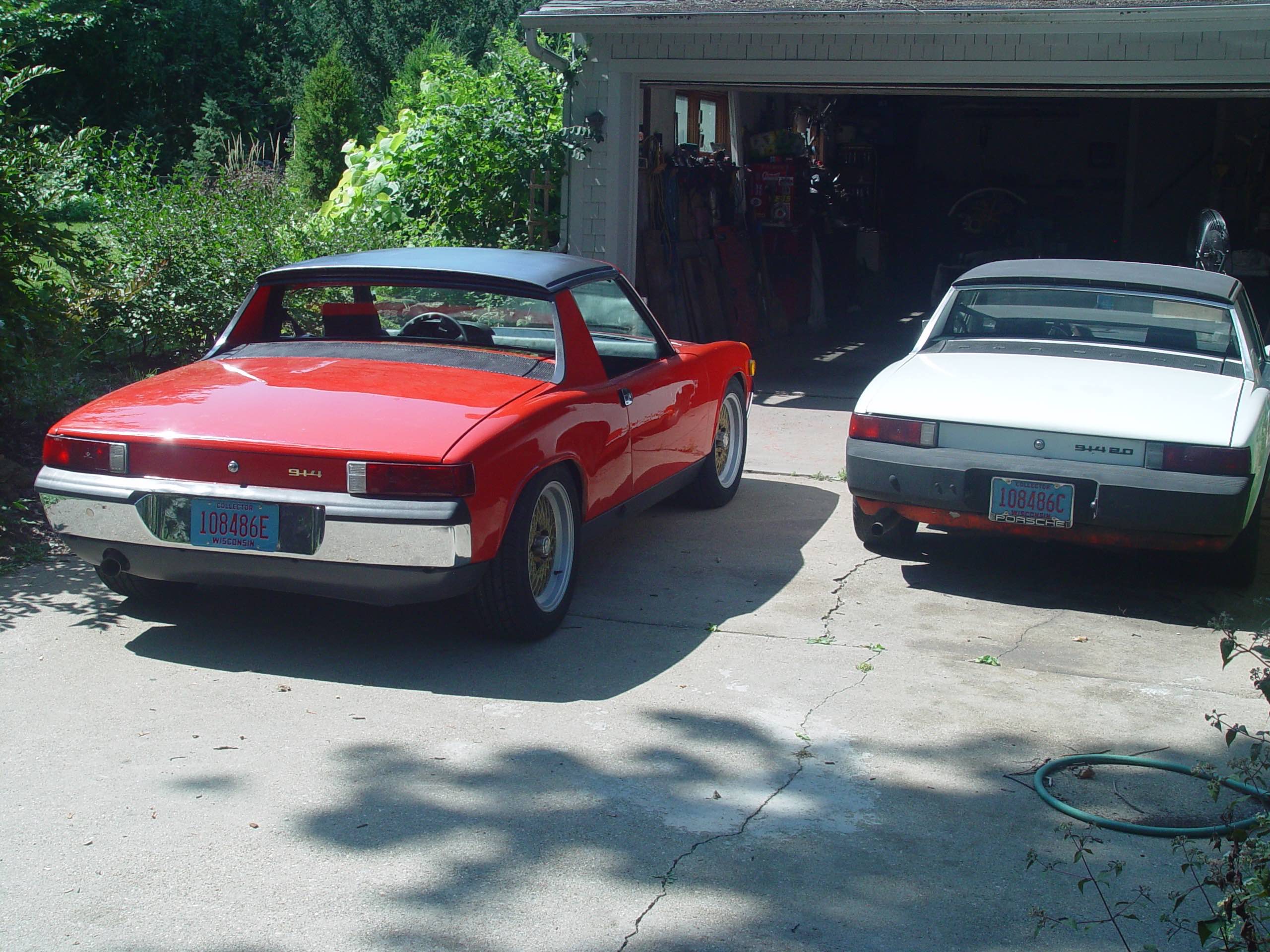

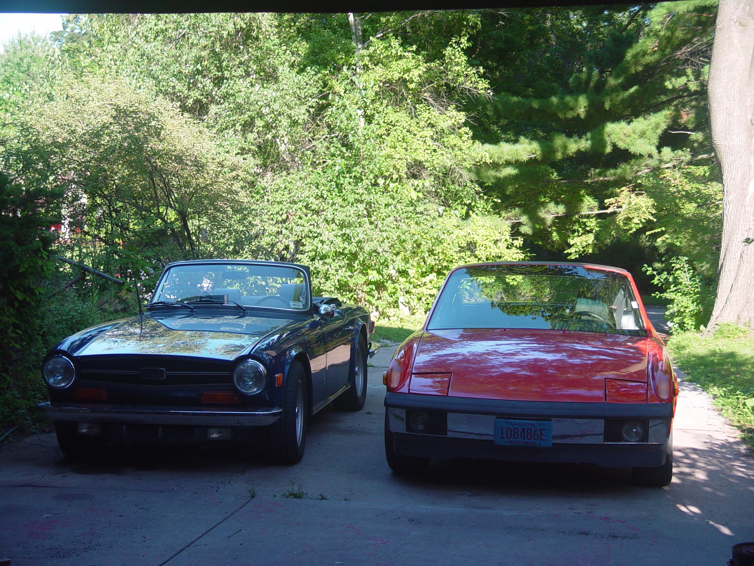

Took the new 914 for a bit more of a spin. Long punch list but a lot of parts are one the car rather than waiting to be cleaned and painted.
Thing is it is scary quick. Not sure I know what to do with such a thing, but figure I will learn. Thank God I put in taller 4th and 5th. Starting in second is getting to be a habit.
Then it is time to get it used to older stable mates. Though the red is a 72 and the blue a '73.
Now a few more things and the door cards will be in. Then a longer drive. Then coast to coast, nationwide.

Great looking TR6
