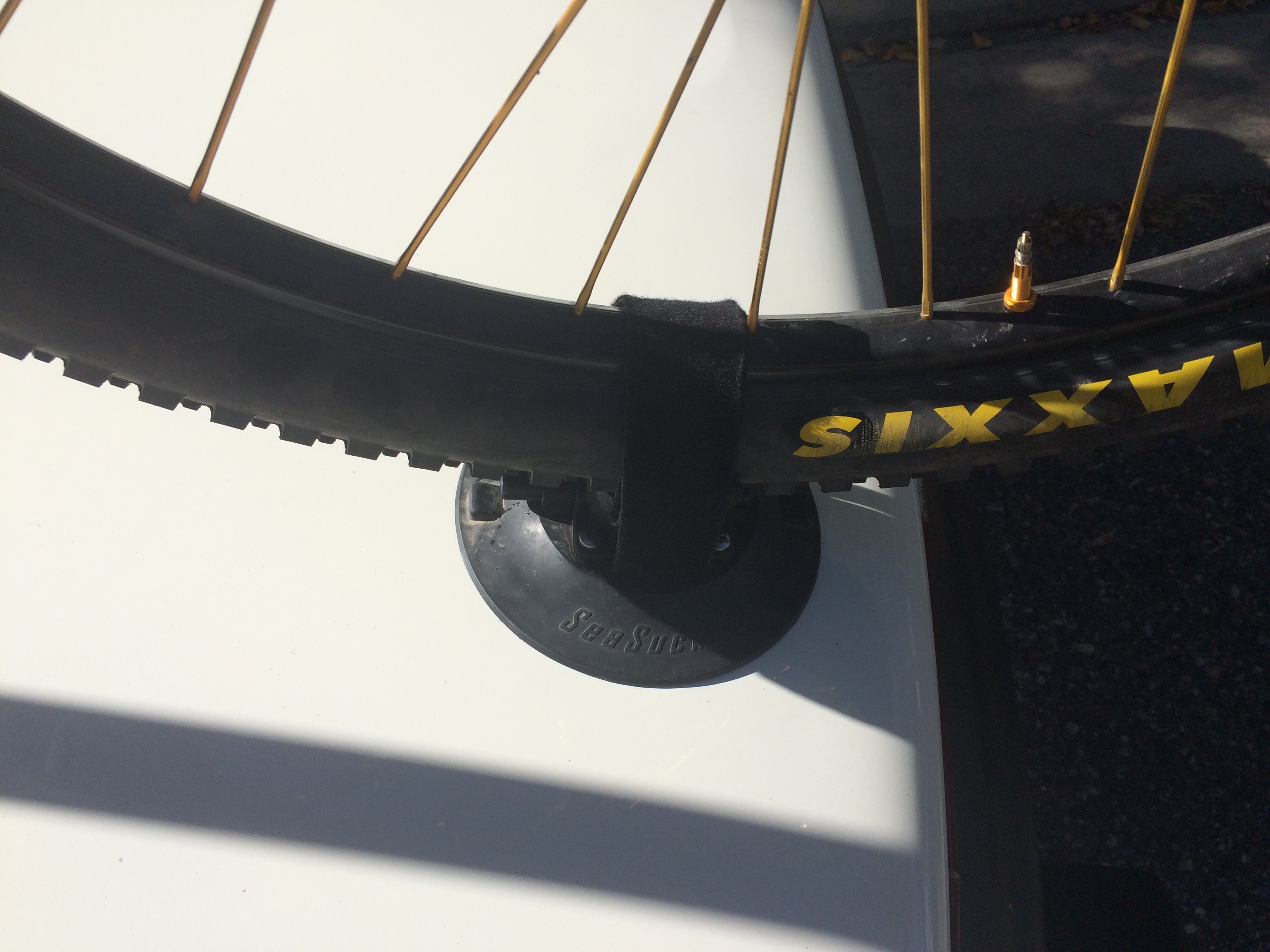

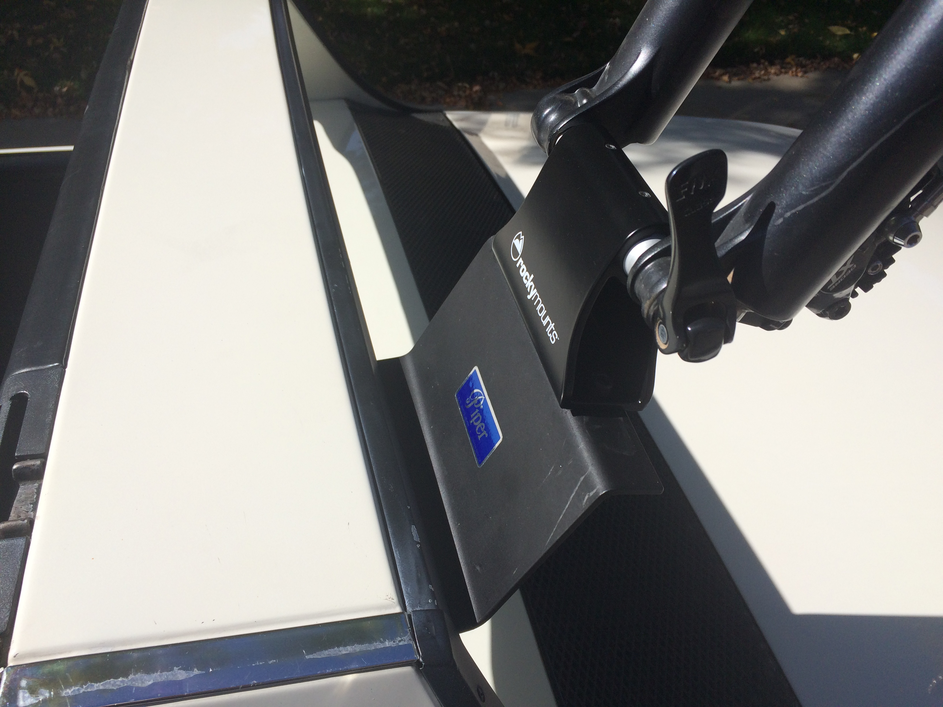

Modified pieper ski rack with Rockymounts thru axle fork adaptor and a sear sucker suction cup rear mount

Ferg   Modified pieper ski rack with Rockymounts thru axl...   Oct 8 2016, 02:23 PM
Ferg   RE: Bike Rack Compilation Thread   Oct 8 2016, 02:24 PM
Ferg   RE: Bike Rack Compilation Thread   Oct 8 2016, 02:26 PM
