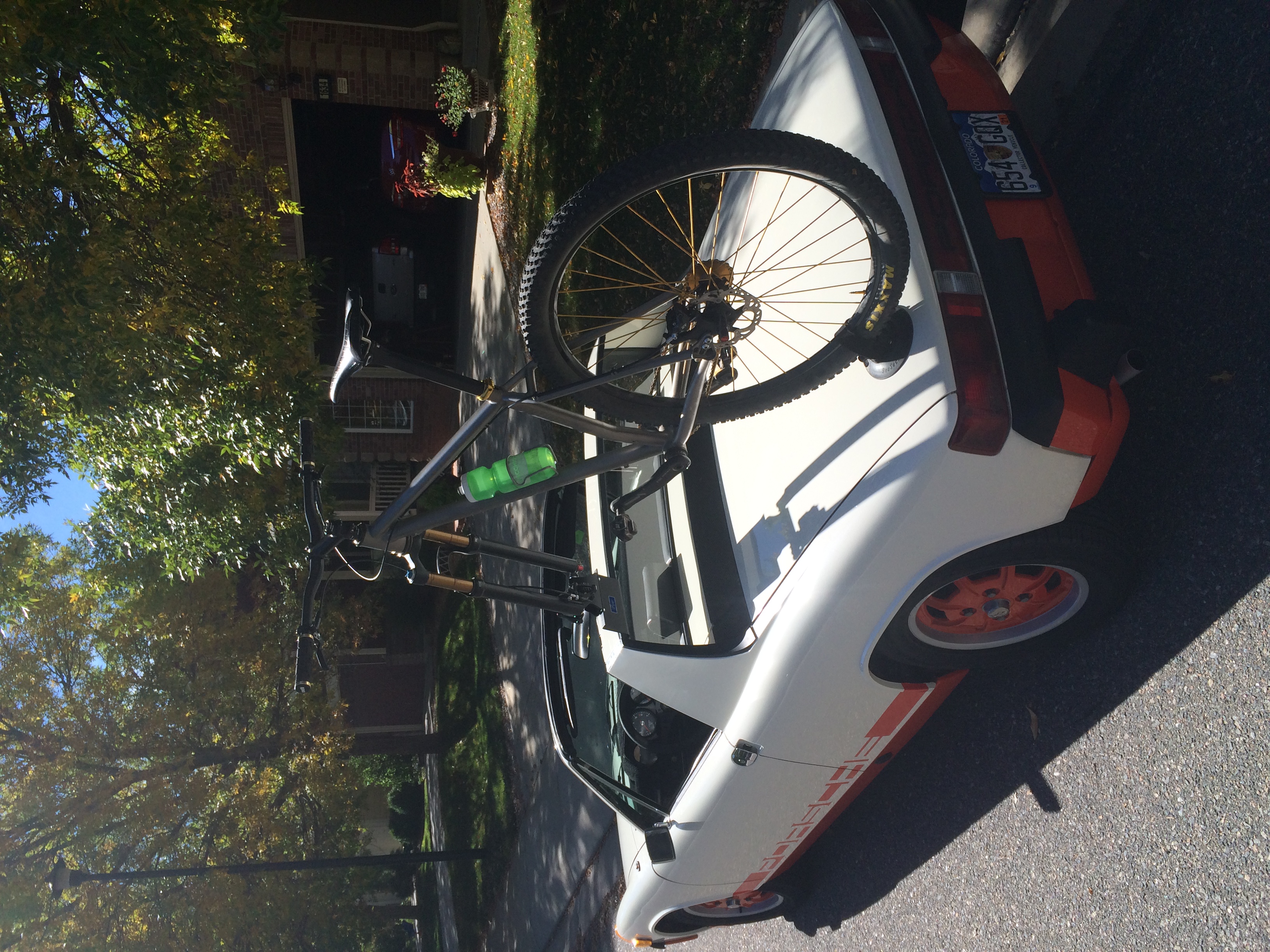

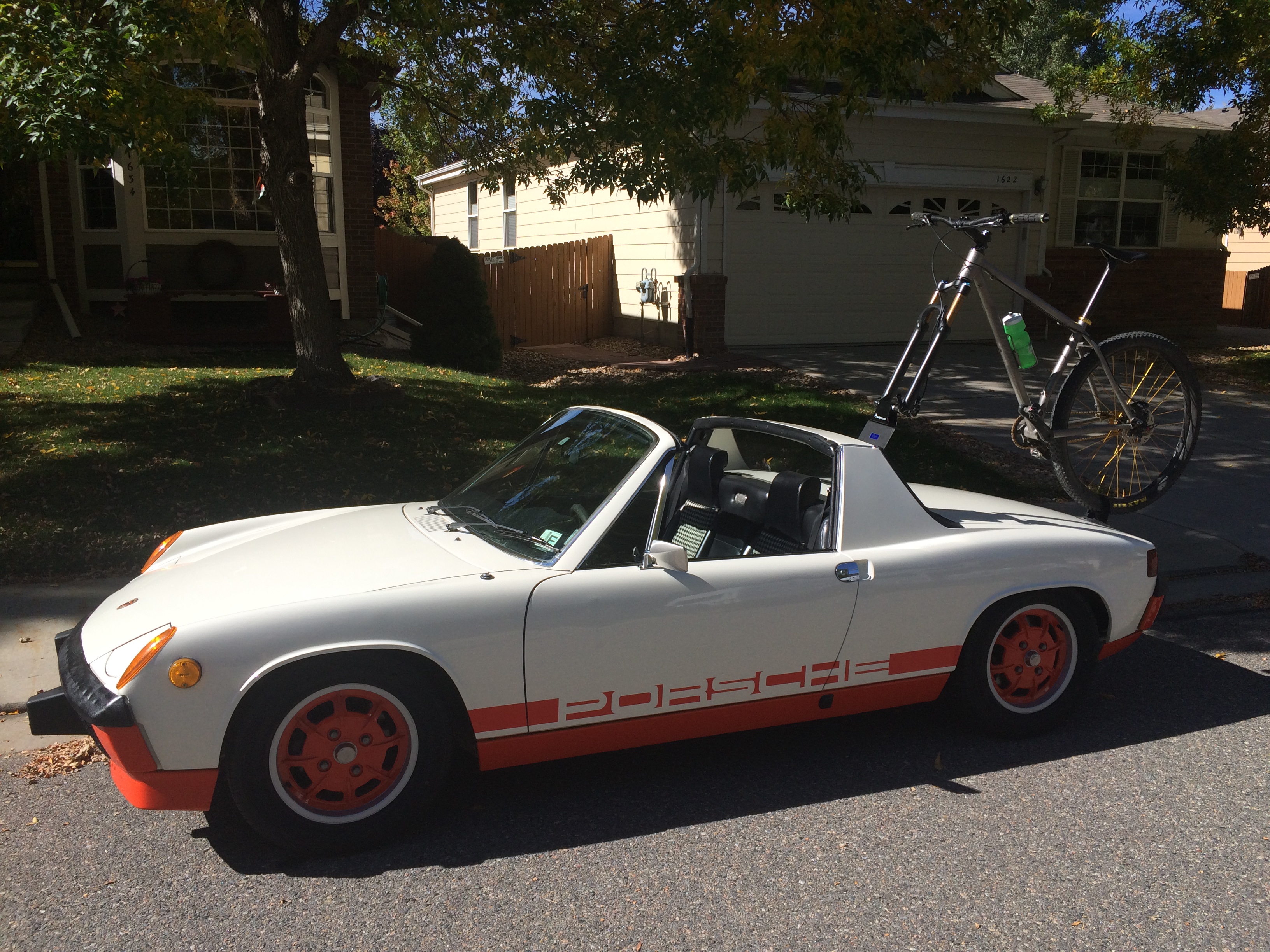

Ferg   Modified pieper ski rack with Rockymounts thru axl...   Oct 8 2016, 02:23 PM
Ferg   RE: Bike Rack Compilation Thread   Oct 8 2016, 02:24 PM
Ferg   RE: Bike Rack Compilation Thread   Oct 8 2016, 02:26 PM
Jeff Bowlsby   If that PO only knew what he had! At least 2 ...   Oct 8 2016, 07:17 PM
Rand   Love it. Love the new Creamsicle, and the bike rac...   Oct 8 2016, 02:57 PM
RobW   F ing show off! Nice work! :headbanger:   Oct 8 2016, 04:11 PM
Ferg   He was told and knew or had an idea. He Didn...   Oct 8 2016, 07:24 PM
