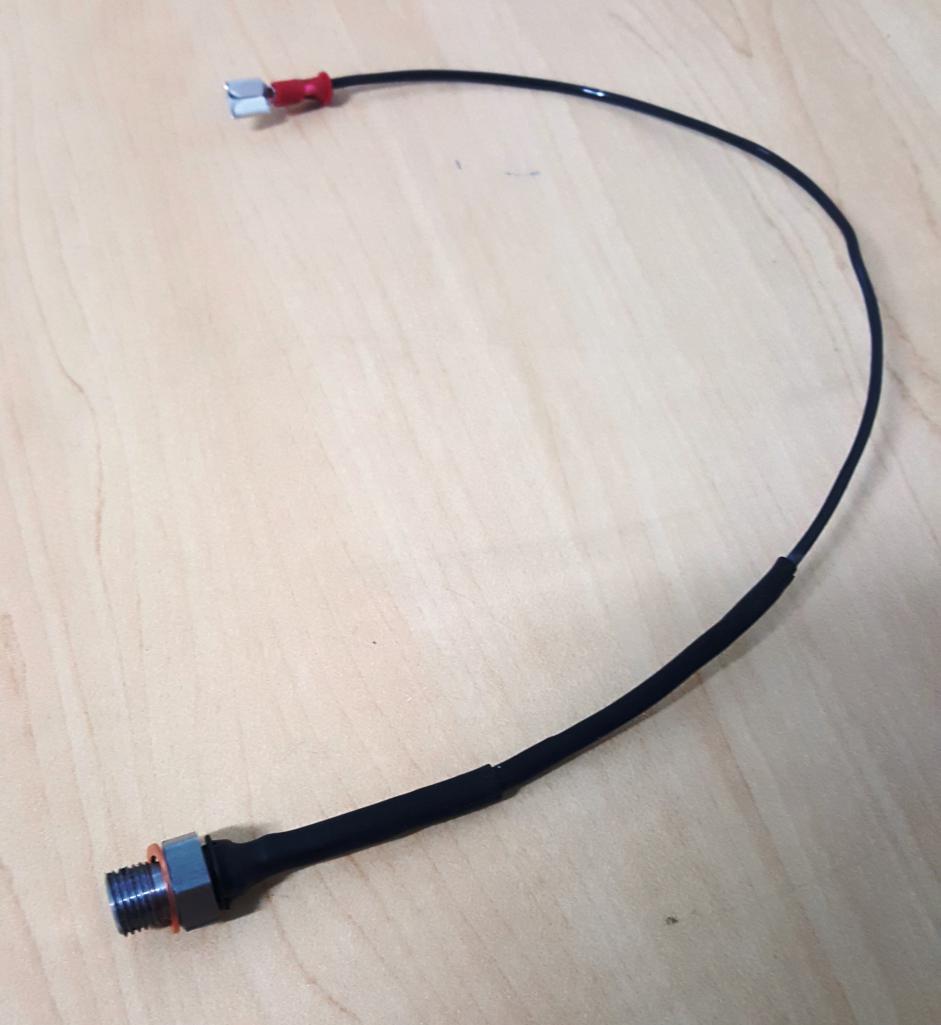

Got on these a little earlier than I planned (burning some midnight oil). Have the 1st prototype part done. It tests out good, but I'm looking at a couple different techniques to assemble that I want to try and test before the full production
I'll be working on these tomorrow. Looking at assembly starting this weekend, so I'm opening up the GB so it can be done with the other 2. I'm quite happy how these have turned out. Final production will be using a brass clip like OEM, I will have them in shortly, but needed to actually put this in my car after bench testing. Attached thumbnail(s) |

Mikey914 Well I have the spec for the 012, so I can make it... Sep 17 2016, 10:03 AM
Dave_Darling They're physically the same, the only differen... Sep 17 2016, 10:27 AM

Dave_Darling I was mis-remembering the CHT sensor info. What I... Sep 17 2016, 10:51 PM

Mikey914 Well looks like there is enough commonality that t... Sep 18 2016, 12:43 AM
McMark I forwarded my info to Mark so he can proceed with... Sep 20 2016, 08:14 PM
Mikey914 SO,
As noted we will be making the Original Custom... Sep 21 2016, 12:17 AM

McMark This CHT should never be used with the 73 ballast ... Sep 29 2016, 07:19 AM

Mikey914 Drawing done. Stock inbound and will be cutting me... Oct 4 2016, 04:46 PM

Mikey914 We are starting to cut metal and have the componen... Oct 18 2016, 10:19 AM

Mikey914 Paul Anders mentioned they were interchangeable. C... Oct 20 2016, 02:44 AM

Mikey914 I’ve done some research into what Paul Anders de... Oct 22 2016, 09:41 AM
