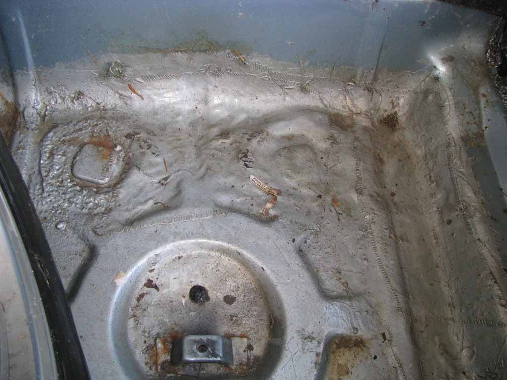

The required rust repairs of significance will entail a partial front trunk pan and minor hell hole repair so in the grand scheme of things a great starting point.

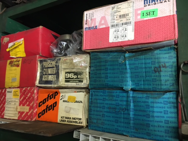

I am now about three weeks out from engine rebuild and paint. My air-cooled mechanic has a stash of NOS German Parts that will be used, so that is beyond awesome. Should take several weeks and I will also use the 4 NOS Bosch Injectors that I recently picked up.
I am scurrying around this week trying to pick up the last of the donor parts required, just need some rear trunk hinges (thinking about the J West kit) if anyone can chime in with their experiences with that product.
Also need to do a 914 Rubber order and source a front trunk pan and I think I will be good to go.

Calvinator2016   Not all is perfect however. Here are pics of the ...   Apr 21 2017, 08:28 PM
