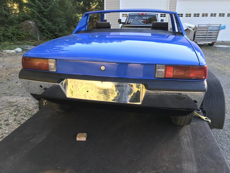

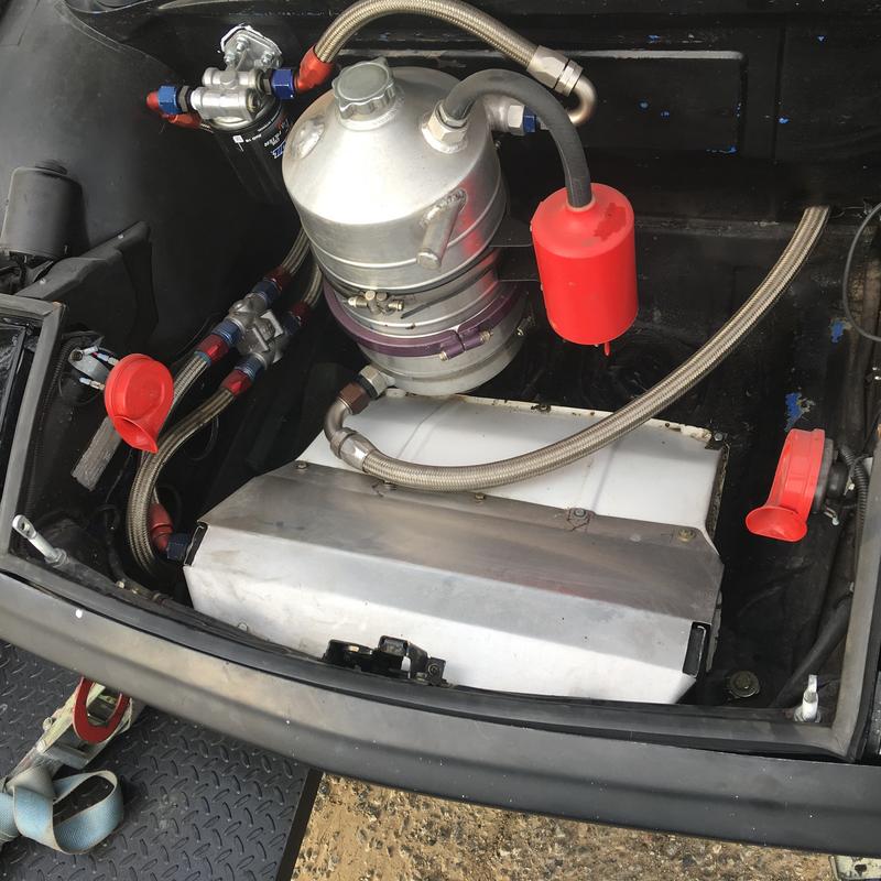

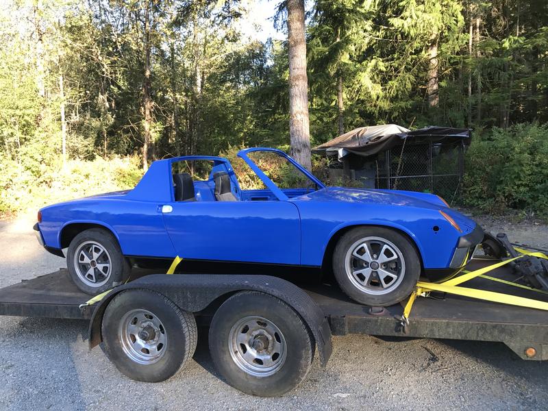

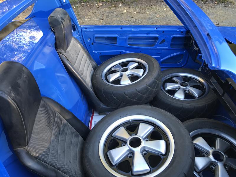

QUOTE(arne @ Sep 19 2017, 06:01 PM) *
Here is the Outlaw:
(IMG:http://www.914world.com/bbs2/uploads_offsite/i.imgur.com-21443-1505925313.1.jpg)
(IMG:http://www.914world.com/bbs2/uploads_offsite/i.imgur.com-21443-1505925313.2.jpg)
(IMG:http://www.914world.com/bbs2/uploads_offsite/i.imgur.com-21443-1505925313.3.jpg)
(IMG:http://www.914world.com/bbs2/uploads_offsite/i.imgur.com-21443-1505926526.1.jpg)
(IMG:http://www.914world.com/bbs2/uploads_offsite/i.imgur.com-21443-1505926526.2.jpg)

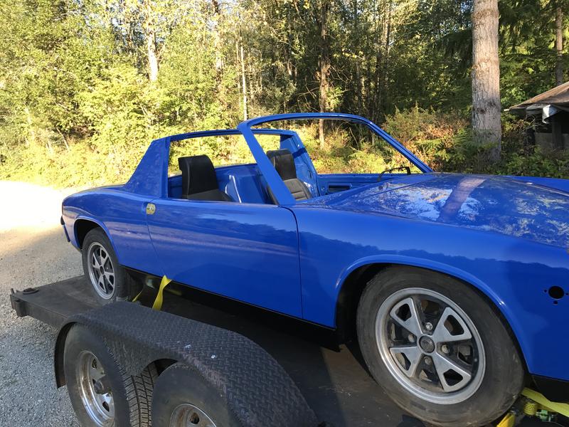

And here is the Pretty Car project:
(IMG:http://www.914world.com/bbs2/uploads_offsite/i.imgur.com-21443-1505925313.4.jpg)
(IMG:http://www.914world.com/bbs2/uploads_offsite/i.imgur.com-21443-1505925314.5.jpg)
(IMG:http://www.914world.com/bbs2/uploads_offsite/i.imgur.com-21443-1505926526.3.jpg)
(IMG:http://www.914world.com/bbs2/uploads_offsite/i.imgur.com-21443-1505926527.4.jpg)
