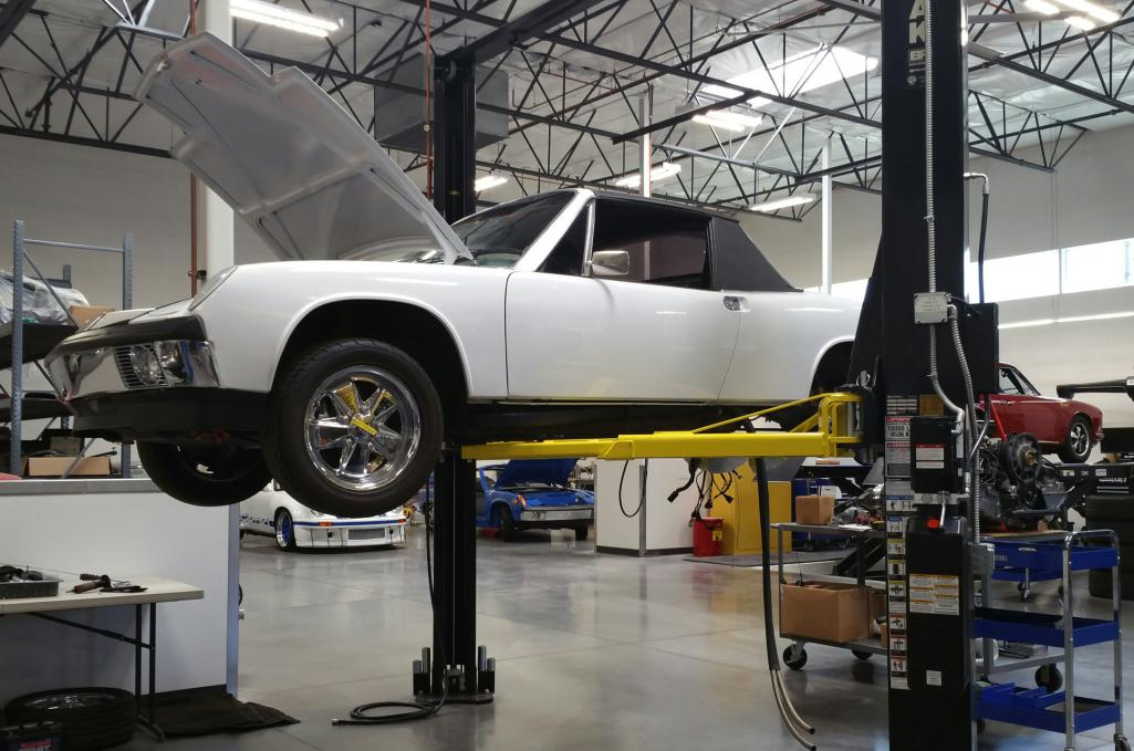

My 914 finally moved up the production line at PMS. Again thanks to Perry for the engine tins. I think I can see light at the end of the tunnel.

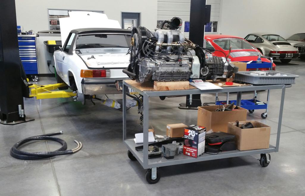

Coondog   One year later my car is back in PMS shop this tim...   May 5 2017, 08:00 PM

Coondog   Thanks to Perry my 3.2 motor is back in business. ...   Sep 6 2017, 03:06 PM
Coondog   More pics   Sep 7 2017, 08:16 PM
Coondog   My 914 finally moved up the production line at PMS...   Sep 28 2017, 04:40 AM
Cairo94507   How very cool. Loving the progress pictures. :be...   Sep 28 2017, 06:29 AM
Perry Kiehl   Looking good!   Sep 28 2017, 07:23 AM
