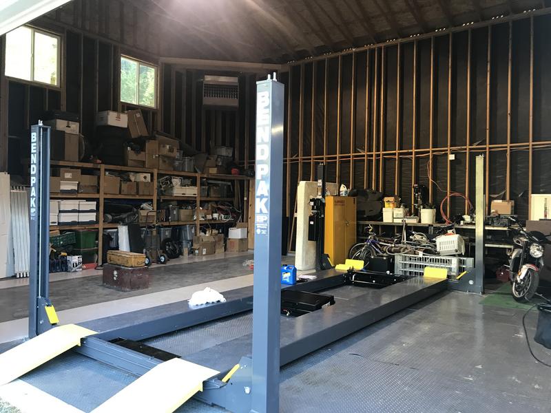

Lift delivered and installed today. It's a massive Benpak 14XL 4 poster - I would have preferred a smaller lift but I also have a large crew cab Cummins diesel long bed to lift that is way too big to put on a 9k lift (plus my concrete floors are only about 6 inches, rebar, but not enough for a 2post lift).
At 22 ft long. it consumes almost the full width of my 30x50 ft shop:

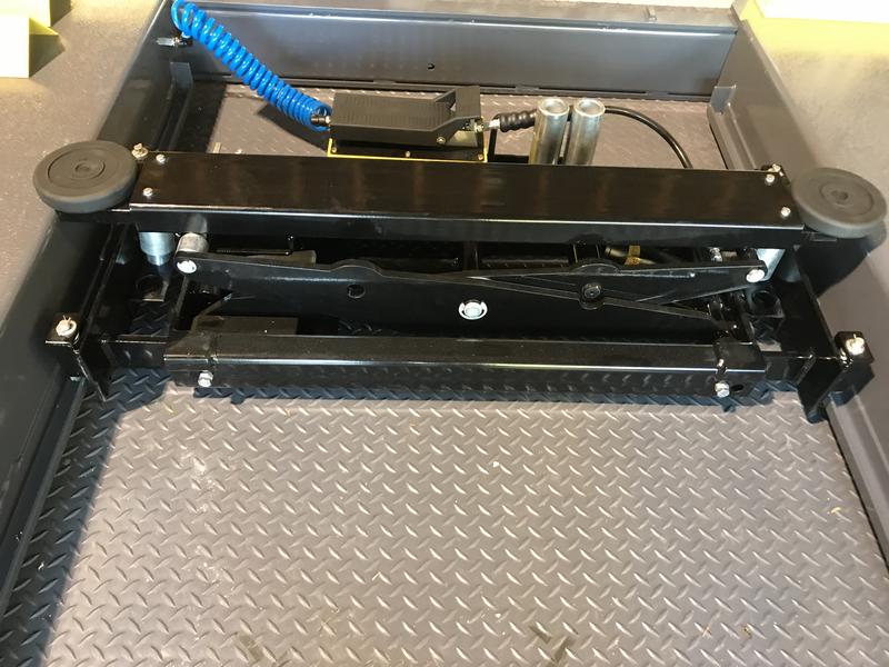

To get cars off the ramp, I added a cool 7k lb air powered scissor lift - the lift slides in the middle between the ramps and when weighted, it locks down into place. I added a flat metal cross member that also slides and will hold floor jacks/bottle jacks (it's the black panel by the ramps), so I just lift the car, place the jack stands, and then lift the other end. You can add two lifts and link them via an air hose kit to lift the entire car off the ramps - I will probably add another air lift but wanted to try it out first. The middle box is a 15 gallon capacity oil tray for doing oil and transmission fluid changes.
(IMG:http://www.914world.com/bbs2/uploads_offsite/i.imgur.com-21443-1507262999.2.jpg)
The ramps are like 20 feet long - I can almost place 2 914's on the lift! It's total overkill.
