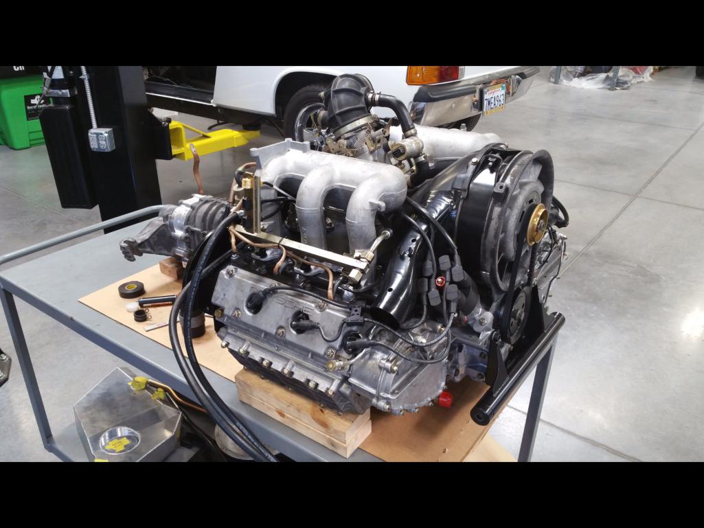

Heres a pic of my 3.2 motor mated to the trans. I have been asked why I didn't add some powder coating bling to the usual engine components.
This was on my list but I felt it was more wise to put those funds into my rebuilt trans.
I stepped up and had a WAVETRAC ATB Differential and a Patrick magnesium Intermediate Plate installed along with other goodies.
The engine bling can wait another day.

Why a magnesium intermediate plate?
mag is only 65% as stiff as aluminum (it's tension modulus) In a gear case, stiffness is the key thing you need, you'd be better off with the stock aluminum int. plate.
That's why aluminum 911 engine cases are superior to mag.

Patrick's replacement intermediate plate is billet aluminum. (IMG:style_emoticons/default/smile.gif)
That car is looking great!! Shouldn't be too long until you're driving, right?

Yes your correct it is billet aluminum, got it backwards. They removed the mag plate. Hoping Mr. Patrick will call me soon so I can travel
to Phoenix and trailer the car back to Calif for some PCH cruising.. (IMG:style_emoticons/default/driving.gif)
