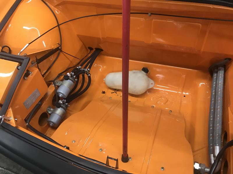

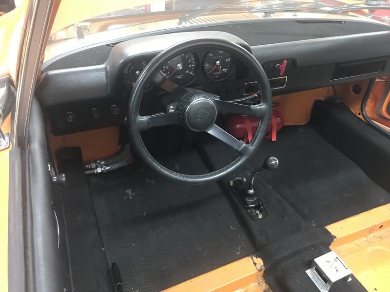

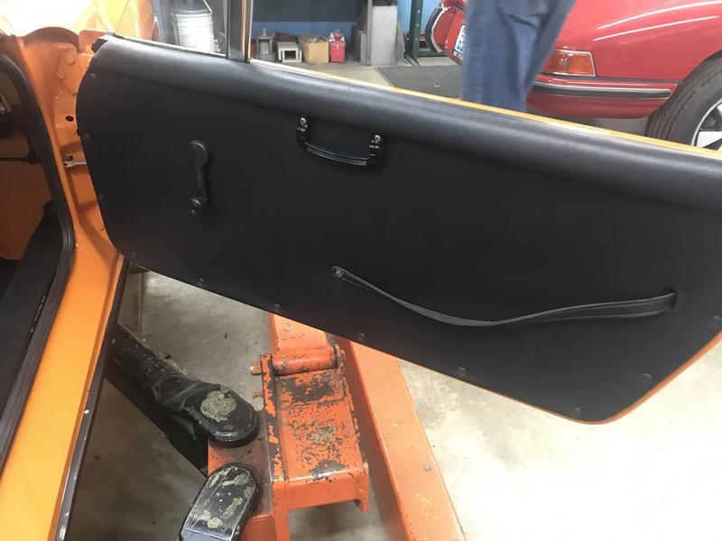

Thanks for the tip on the door panels. I am looking at something like this:
(IMG:http://www.914world.com/bbs2/uploads_offsite/i.imgur.com-21443-1507322482.1.jpg)

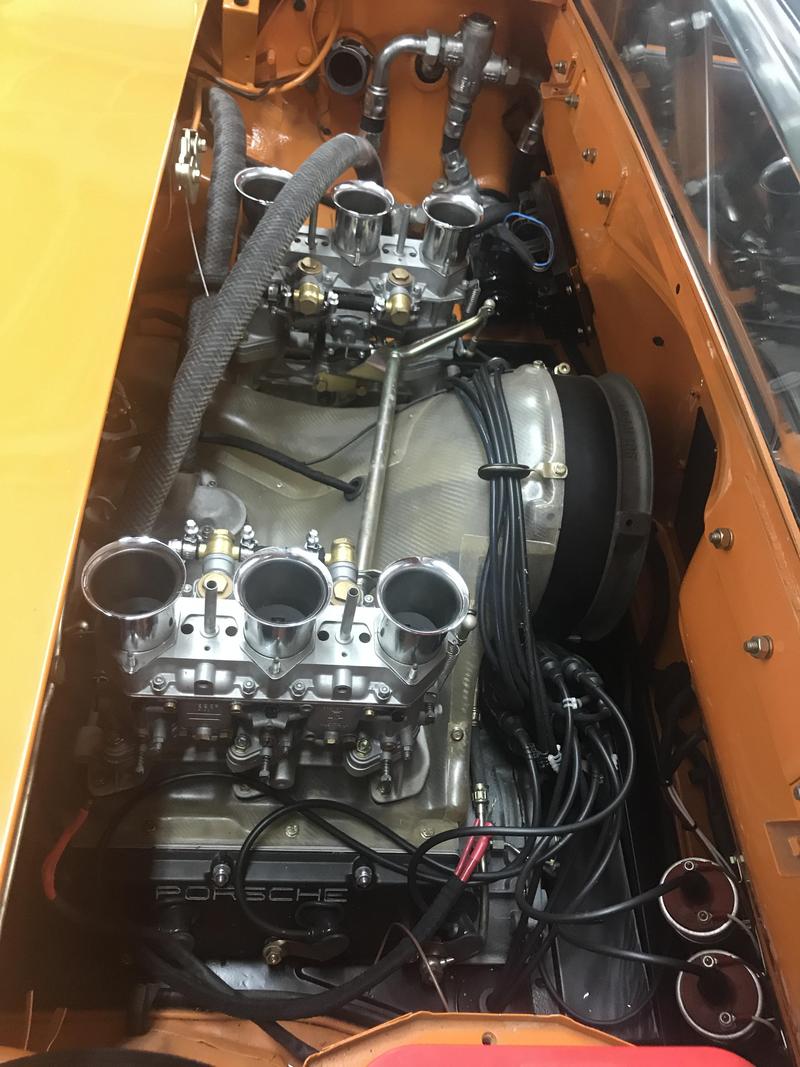

The guy locally who is doing the suspension build is working on one of the most amazing GT tributes I've seen - based on a real -6 body. I am leaning towards this look for the interior - very subdued and tasteful - even though I don't have this customer's budget.
(IMG:http://www.914world.com/bbs2/uploads_offsite/i.imgur.com-21443-1507322483.2.jpg)
The rest of the car is fantastic! Real, unobtanium oil tank/cooler lines etc used, no expense spared. The car will be phenomenal when done. Wish I had the budget.
(IMG:http://www.914world.com/bbs2/uploads_offsite/i.imgur.com-21443-1507322699.1.jpg)
(IMG:http://www.914world.com/bbs2/uploads_offsite/i.imgur.com-21443-1507322700.2.jpg)
I hear you on the limitations of tires for the 14" Fuchs. Again, I have an outlaw 914-6 conversion with the 3.2L and it is running 9" & 8" knock-off Fuchs with Toyo tires that have amazing grip. But for this build, I really want a stock looking sleeper car - and it's not being built to autocross but just as a clean Sunday driver.
