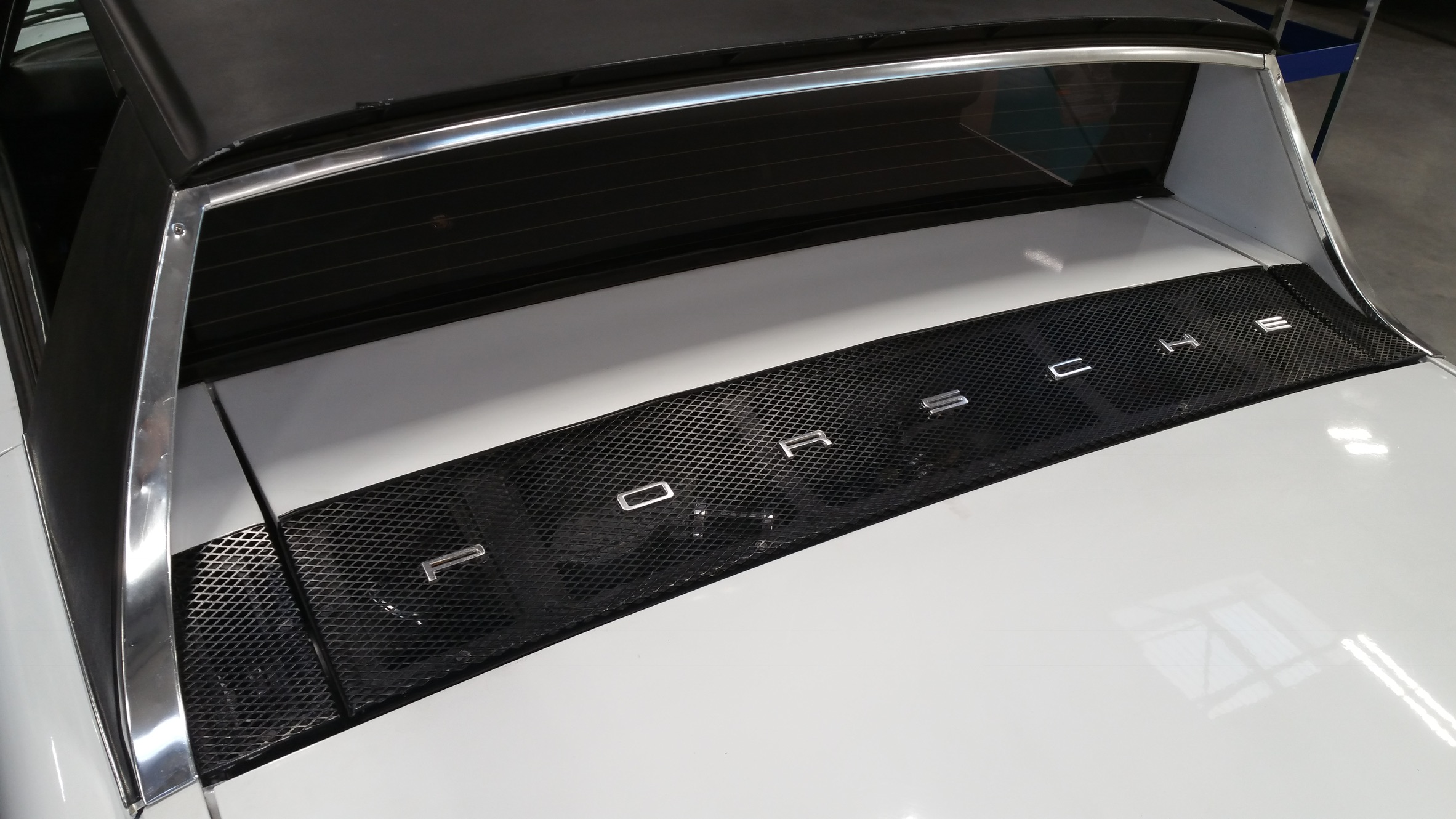

I should have started this along time ago.
Purchased a stock 1.8 two years ago, car found in Suprise Arz.

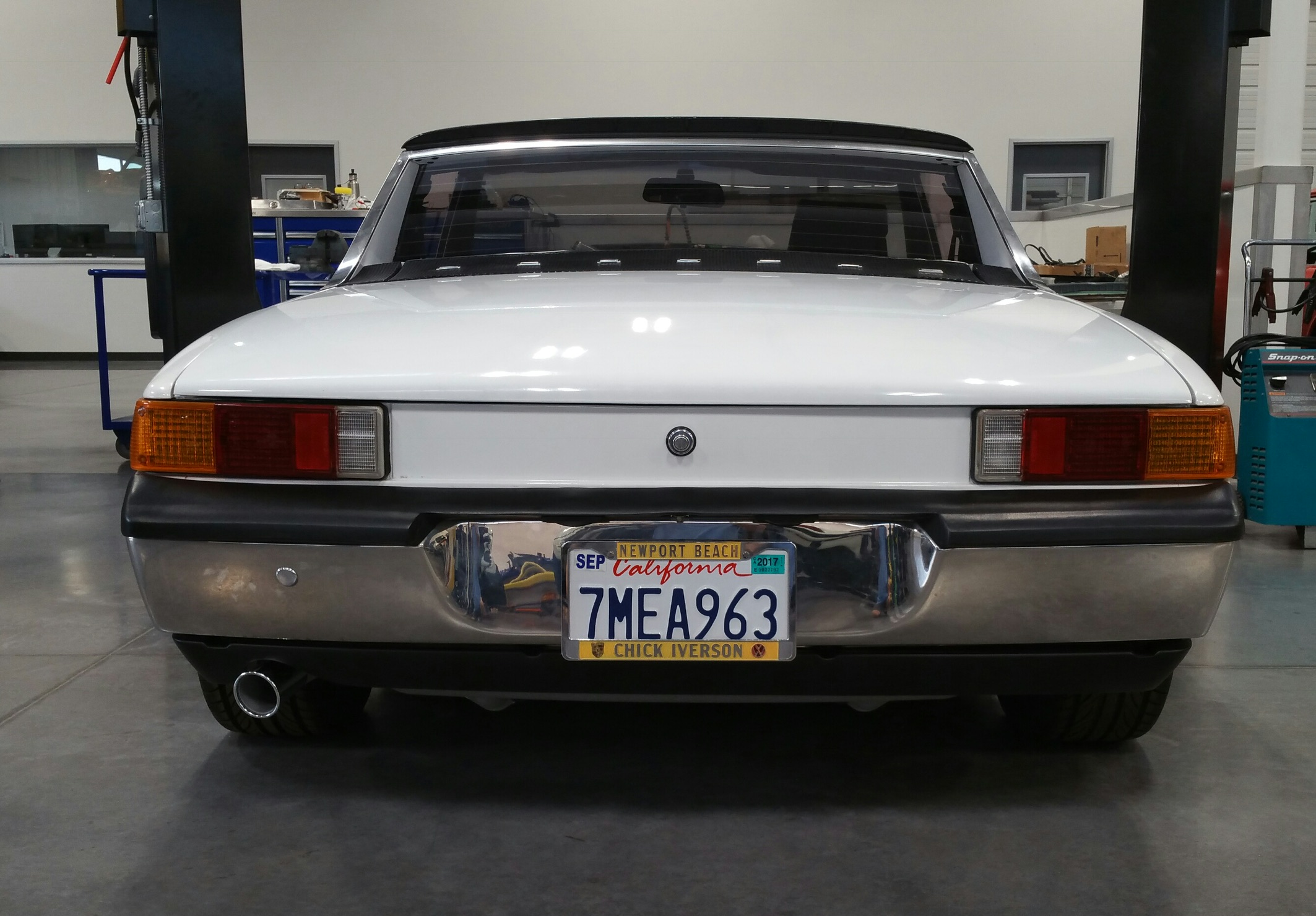

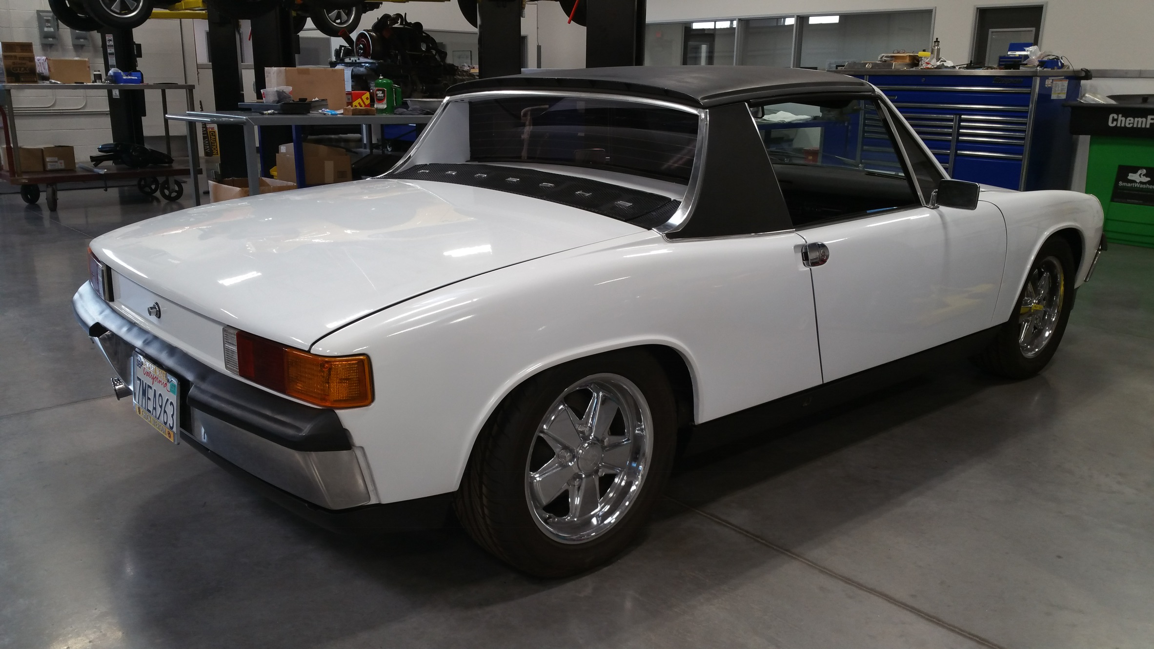

Two part process beginning with full brake, suspension upgrade and back date bumpers, work done by PMS
Before
After
Coondog

Final tune and adjustment and this Patrick build is done (IMG:style_emoticons/default/driving.gif)
