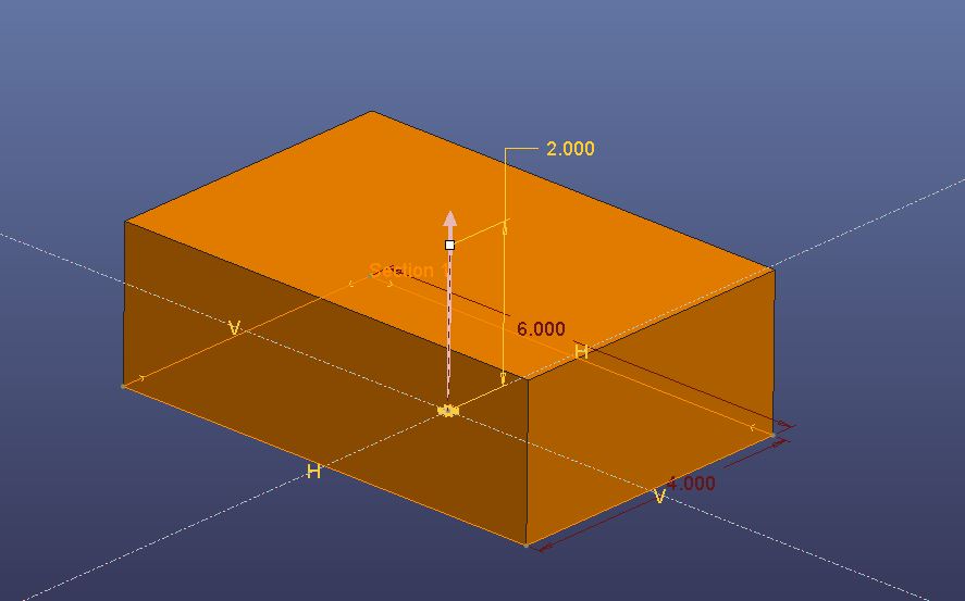

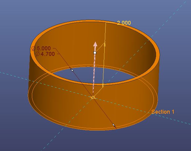

QUOTE(NeunEinVier @ Oct 11 2017, 12:25 PM) *
This 3D modeling stuff boggles my mind, how can it even be done without having the original CAD files for each component? And doing it at home no less...
It's easier once you wrap your mind around the process. Think about modeling a square block, within the software you define where you want the block to be, typically a plane to start. Then you define how big you want the block in 2 of it's three dimensions, lets say 4 inches by 6 inches, then you define how big you want it in the third dimension, lets do 2 inches. This is called an extrude.
For a cylinder, your starting shape would be a doughnut instead of a rectangle
Each feature is broken down the same way, but piling these features on top of eachother makes the part more complex. Some features might be cuts instead of an extrude. Some might be revolves, where you define a center axis and a cross section and the shape is revolved around thew axis. Really complex stuff gets modeled as a set or surfaces, where you can merge and cut the surfaces, or sweep along curved edges. Now take that and multiply by infinity. Easy as cake.
(IMG:style_emoticons/default/tongue.gif)
