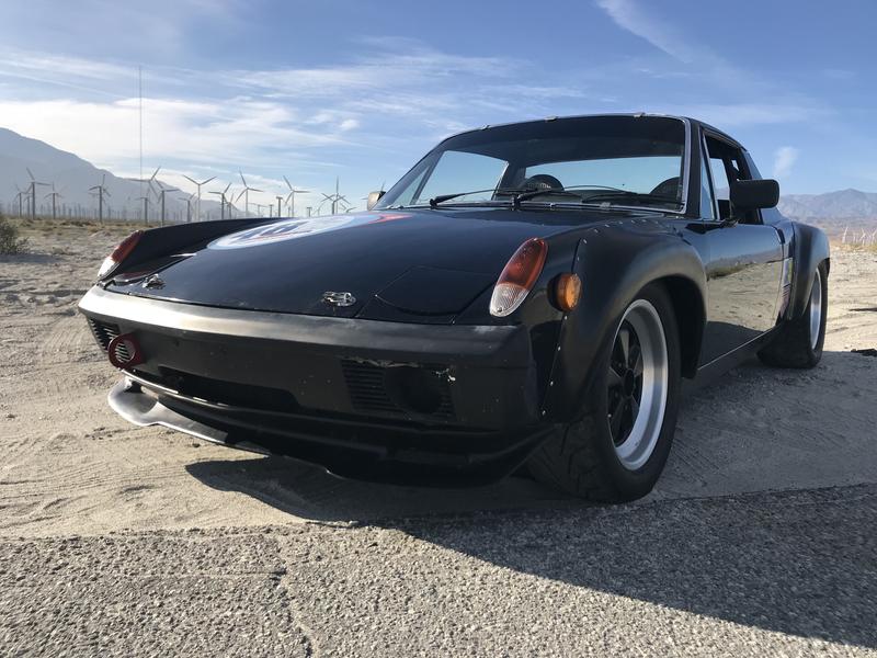

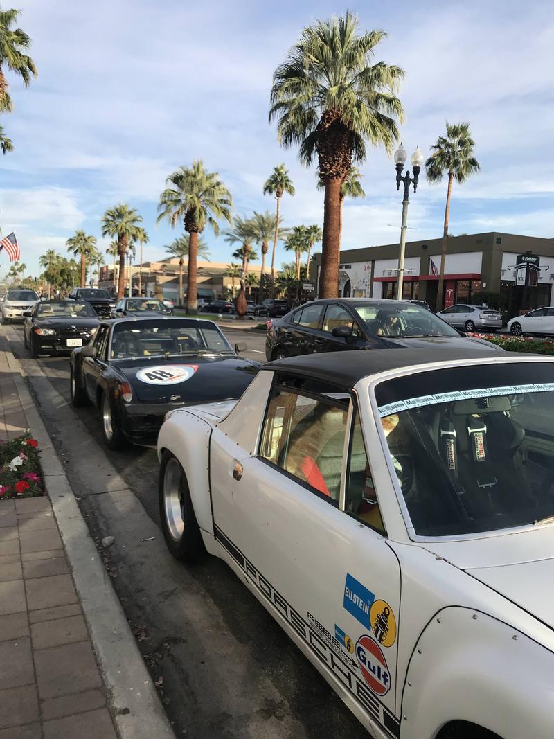

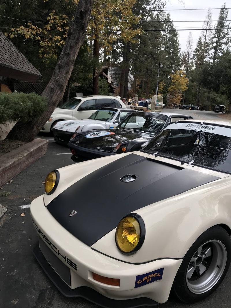

I went to SoCal and had a chance to play with my black Outlaw 914 for a few days to get more inspiration for the current project. I drove with members of the SoCal RGruppe who had on hand about 50 various cool Porsche 911s and 912's. My friend with the 3.6 conversion and I were the only 914's on hand.

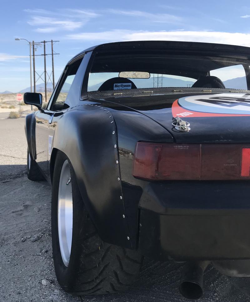

I love this car - especially the attitude. Driving through the ritzier parts of Palm Springs, it was like an upraised middle finger to all the Aston Martins, Bentleys, Ferraris and such. My favorite part was pulling up to a super fancy country club and having the car snort, rip, and smoke (yes, I discovered I need a top end job finally).
(IMG:http://www.914world.com/bbs2/uploads_offsite/i.imgur.com-21443-1510602729.4.jpg)

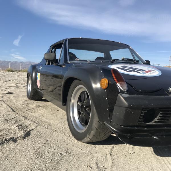

We had a great drive with the RGruppe folks and then peeled off yesterday for some quicker runs up in the mountains.
(IMG:http://www.914world.com/bbs2/uploads_offsite/i.imgur.com-21443-1510602729.5.jpg)
(IMG:http://www.914world.com/bbs2/uploads_offsite/i.imgur.com-21443-1510602729.6.jpg)
