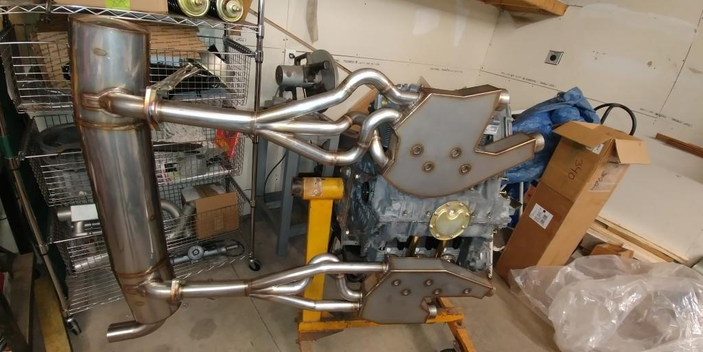

mb911
post Dec 11 2017, 02:49 PM
Posts: 7,845
Joined: 2-January 09
From: Burlington wi
Member No.: 9,892
Awesome.. You should have heat exchangers by now and muffler this week. Here is a picture of your heat exchangers mounted on my engine..Attached Image
