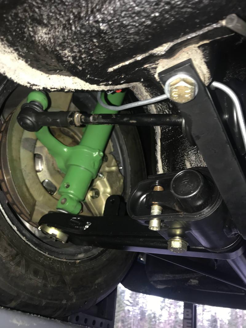

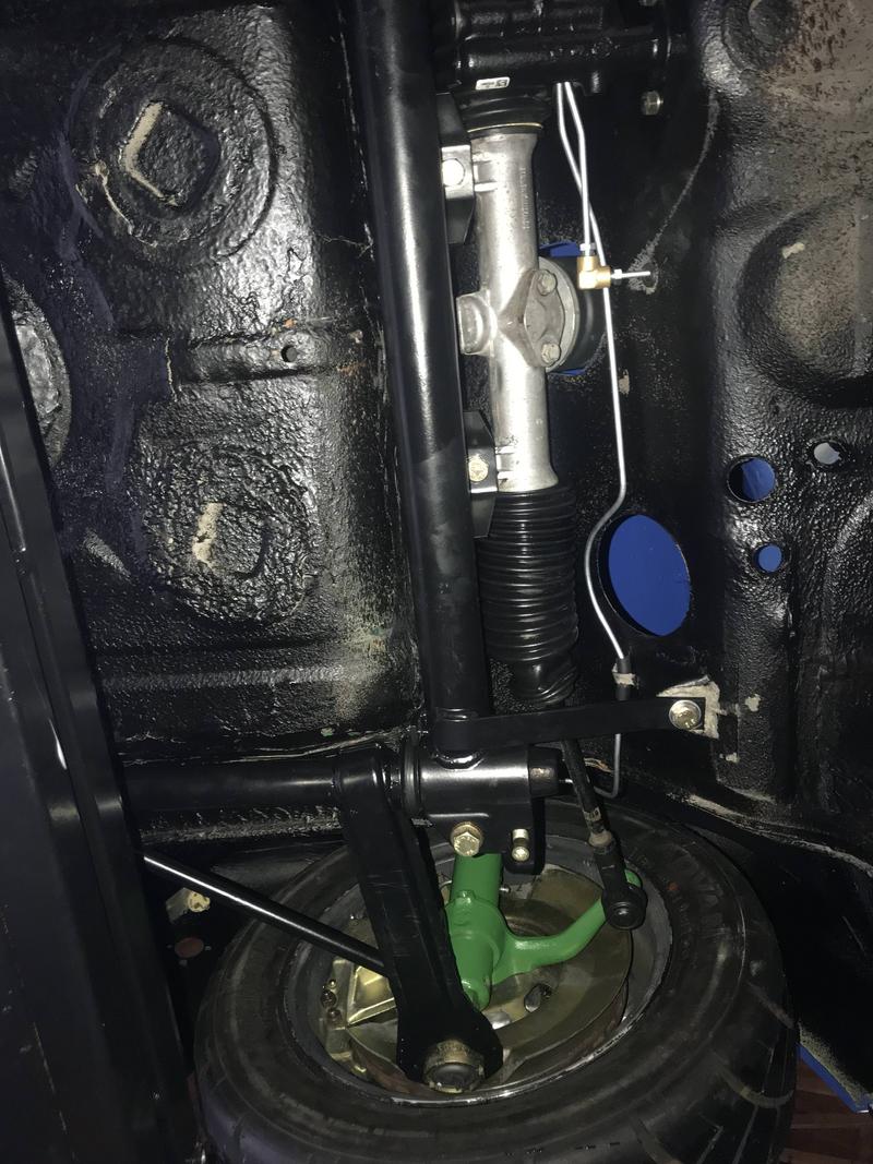

Front and rear suspension installed and looking great with the PMB brakes! I need to do the POR15 a bit better though as there are some bare spots.
(IMG:http://www.914world.com/bbs2/uploads_offsite/i.imgur.com-21443-1513486807.1.jpg)
Note the shiny new brake lines!
(IMG:http://www.914world.com/bbs2/uploads_offsite/i.imgur.com-21443-1513486807.2.jpg)

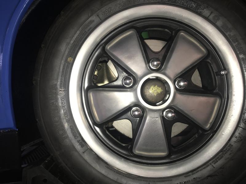

Bolted on the 14" fuchs - geez they are small! I'll live with them a while before looking at 15"s:
(IMG:http://www.914world.com/bbs2/uploads_offsite/i.imgur.com-21443-1513486807.3.jpg)

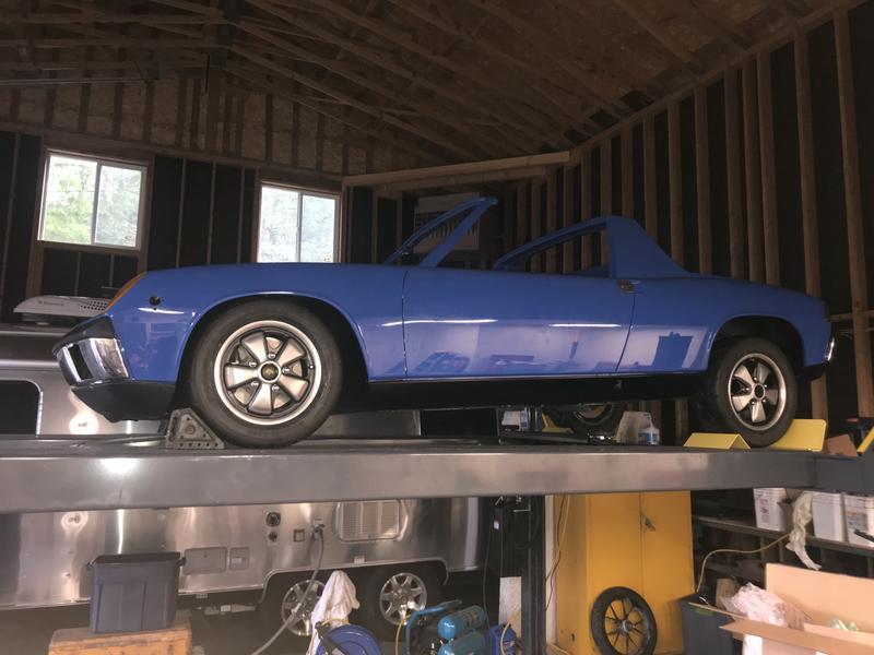

Before and after:
(IMG:http://www.914world.com/bbs2/uploads_offsite/i.imgur.com-21443-1513486808.4.jpg)
(IMG:http://www.914world.com/bbs2/uploads_offsite/i.imgur.com-21443-1513486808.5.jpg)

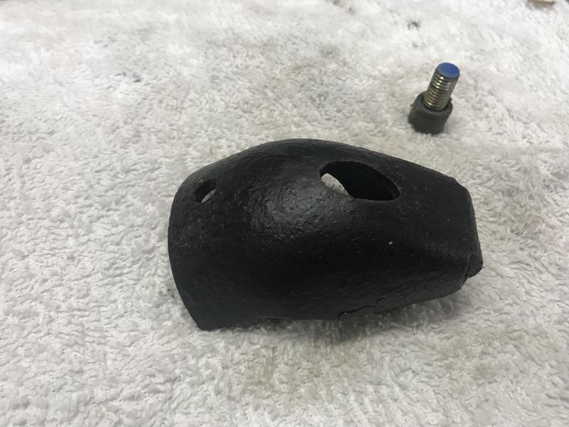

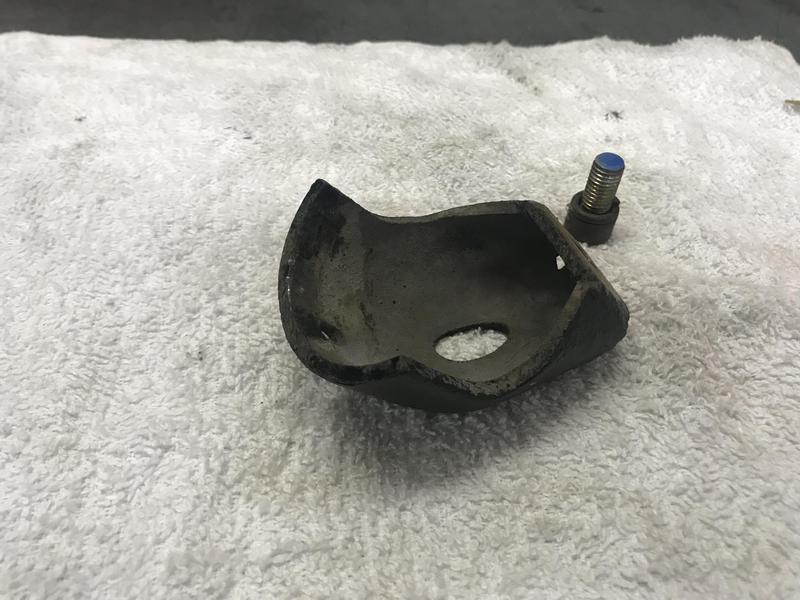

One odd thing - I was missing the guard for the front of the A-arm on the passenger site. Anyone have a spare? Here's the part:
(IMG:http://www.914world.com/bbs2/uploads_offsite/i.imgur.com-21443-1513486808.6.jpg)
(IMG:http://www.914world.com/bbs2/uploads_offsite/i.imgur.com-21443-1513486808.7.jpg)

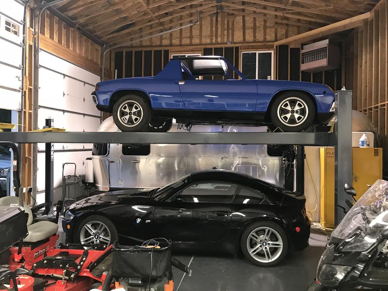

davehg   For fun, also showing its stablemate that is now c...   Jun 25 2024, 10:02 PM
