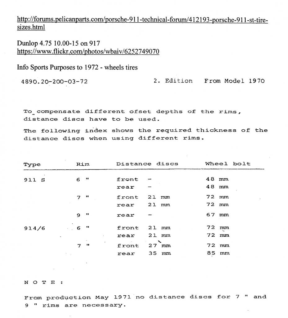

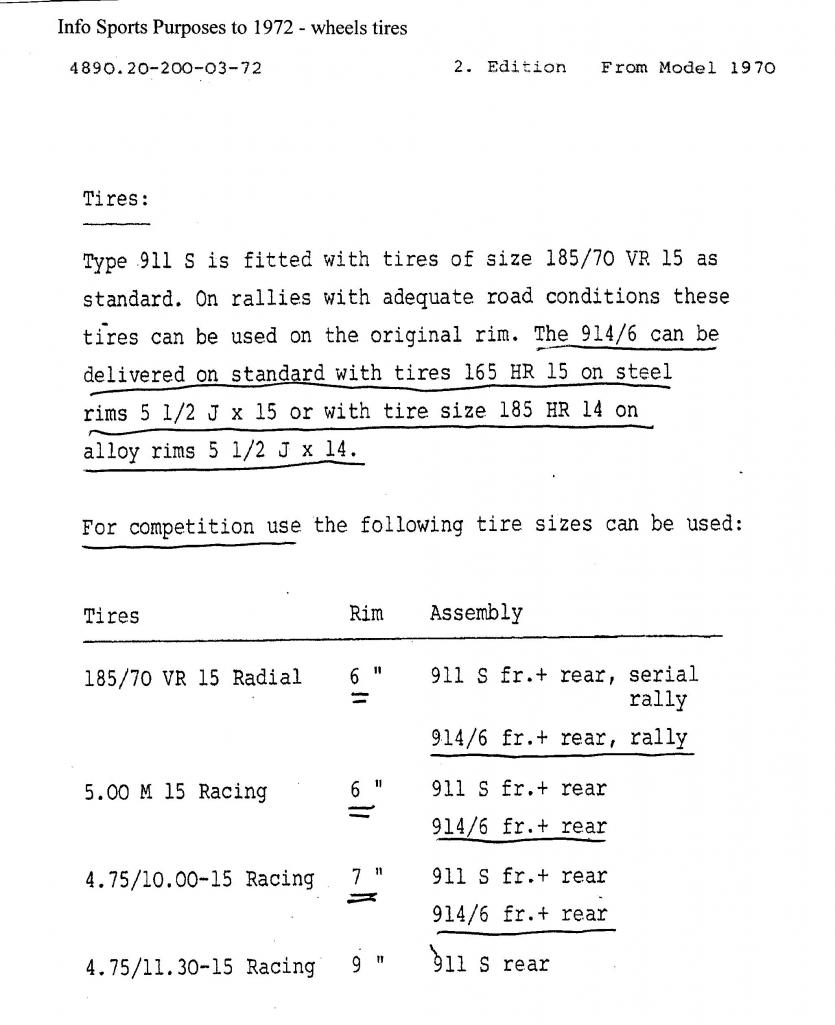

Factory specs - for those intent on duplicating originality
