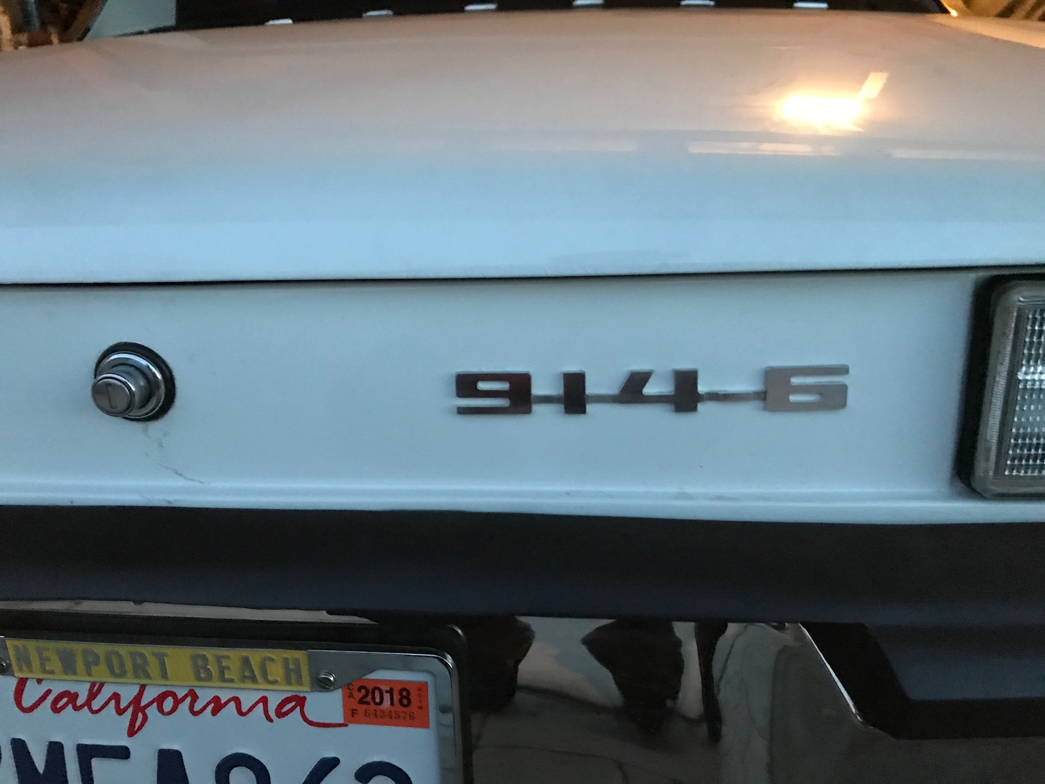

Coondog   Welded in a bracket to mount my spare.......Thank ...   Jan 17 2018, 07:18 PM
Coondog   Another quick mod. Thank you Mike   Jan 17 2018, 07:30 PM
