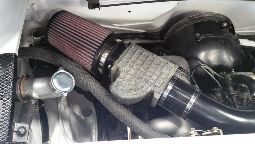

how are you planning to shield the air filter from rain? Maybe you don't have rain issues but I am looking for a solution using the 914-6 GT engine lid and rain getting into the air filter.

buck toenges   how are you planning to shield the air filter from...   Jan 18 2018, 01:24 PM
Coondog   how are you planning to shield the air filter fro...   Jan 18 2018, 05:36 PM
