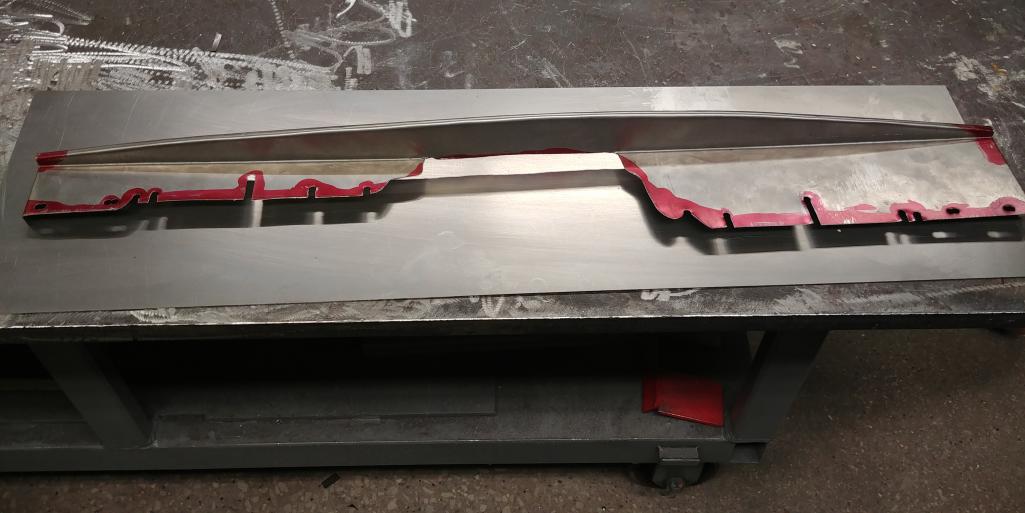

Dave here is a teaser for you..Attached Image
